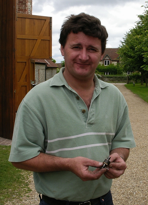

Ian Grace wrote:I fitted the longer rocker shaft rods on the Bed-Pan with the associated bronze rear carrier as I have seen the back end of the shaft break - this happened to Robin Harcourt-Smith last year on his CMS.
The evidence! Photo taken by Ken Martin on the 2007 Light Car Summer Rally. The weak point is obvious - the hole for the securing screw.
