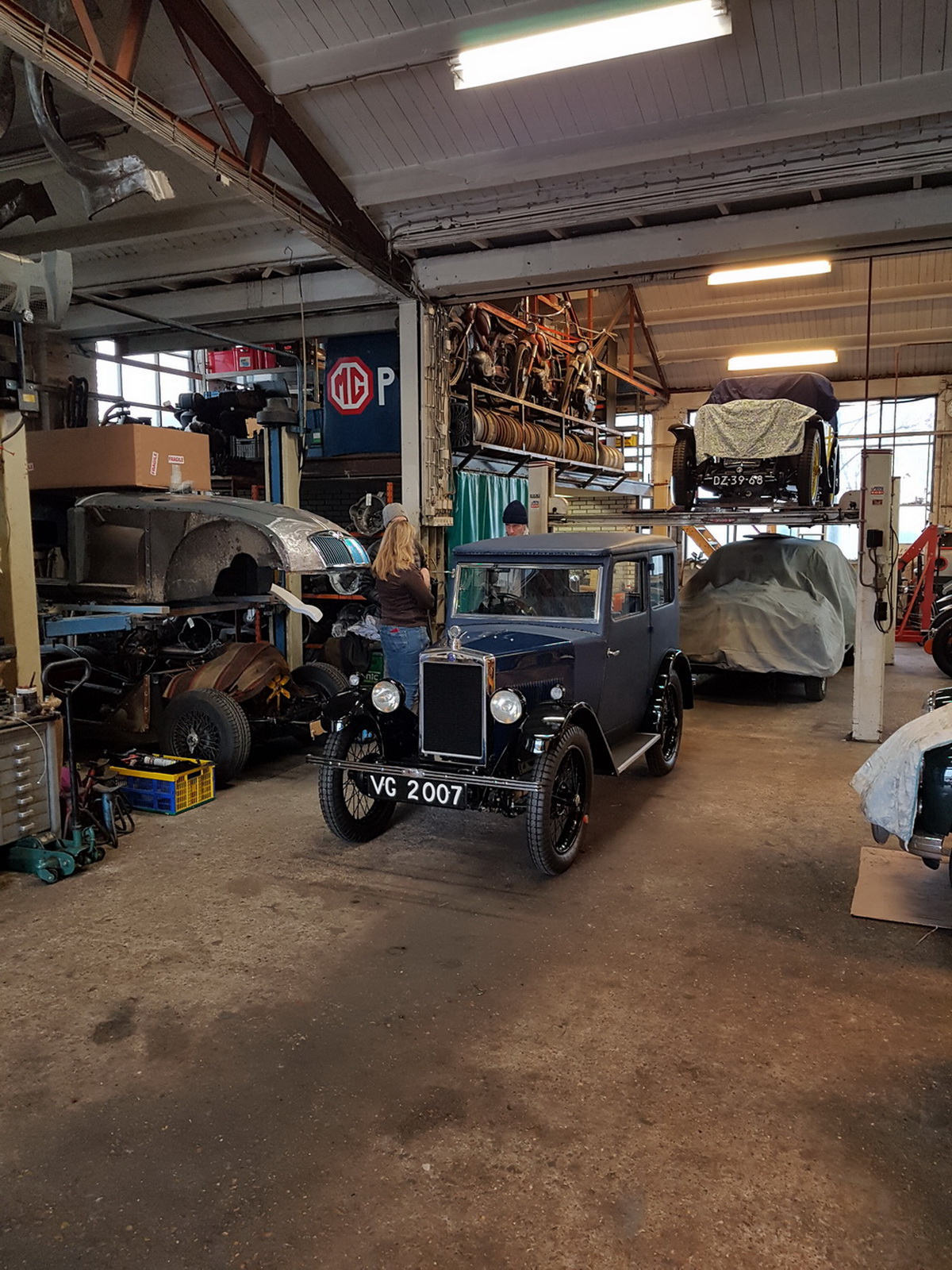

VG is nearing completion. 10 years after buying her from a farm in Bungay she is back on the road. I took her for a little drive and all the mechanical bits are fine and functioning as they should!
Next thing to do is to get a dutch registration and hopefully freeze the original one. wouldnt like to see VG2007 on a new Merc.............
So off to the dutch RDW for a licence and on with the beading and another couple of small jobs.
Regards Halbe

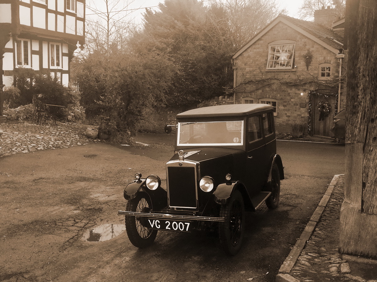

Took VG 2007 for its first real run to the New Year's Day pub meet at the New Inn, Pembridge, about 14 miles from our cottage. We were the first to arrive, so took the opportunity to take some photos and managed to get angles so the moderns were out of shot.
The car performed without fault, except I had starting difficulties - would hardly turn over even after I had charged the battery. We bump started the car to get home, after which I found the earth terminal loose and a bit corroded. Emery paper and a spanner did the trick. It is still underpowered, given the hugely expensive engine rebuild, 12/12 cam and M Type compression ratio, but this may be because it is not yet run in. I'll have more opportunity to tune it and run it on our next visit in July.
