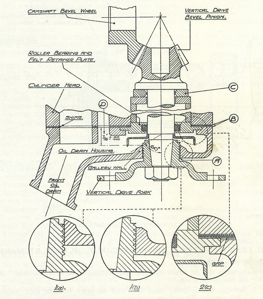

Re: Shim/s under OHC head.
David,
Looking at the drawing, I think you can see that the bearing sleeve supports the thrust washer and in turn the sleeve sits on the felt seal retainer plate. (These days, we use a modified plate that accepts a modern neoprene seal). And this plate rests in the oil housing, so adjusting the location of the housing under the head with shims will adjust the thrust washer, and hence the mesh of the gears.
Does that make sense, or did I have too much Merlot with my lunch?!
Thanks Ian,
Drawing clear, must review the whole lot tomorrow in the daylight.
Where did the drawing come from? Are there others?
David.
David.
I scanned it from Blower. I'll see what else I have.

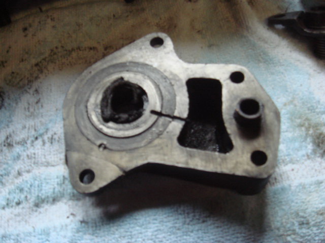

Here's a standard housing, with the original felt seal housing in place, located by a small peg at around 7 o'clock in this image:

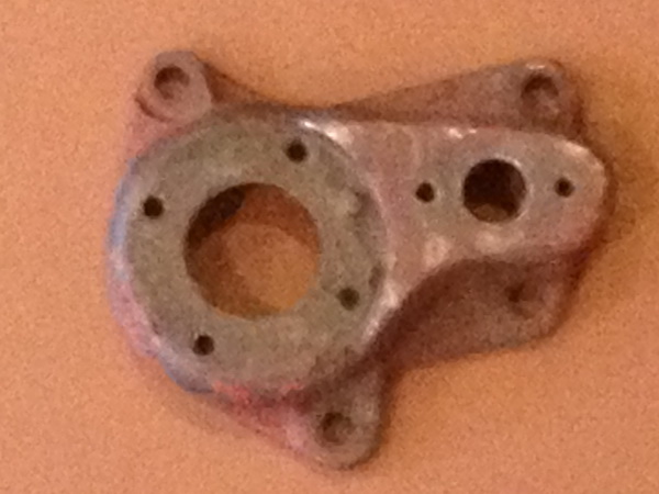

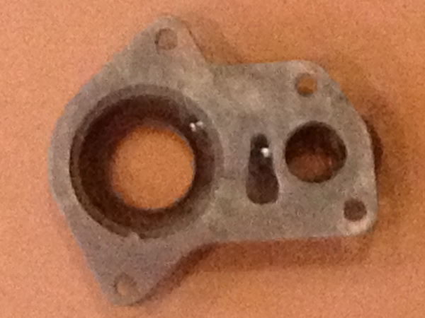

And here's another in my spares collection which is distinctly different:
Does anyone know what engine this is from?
