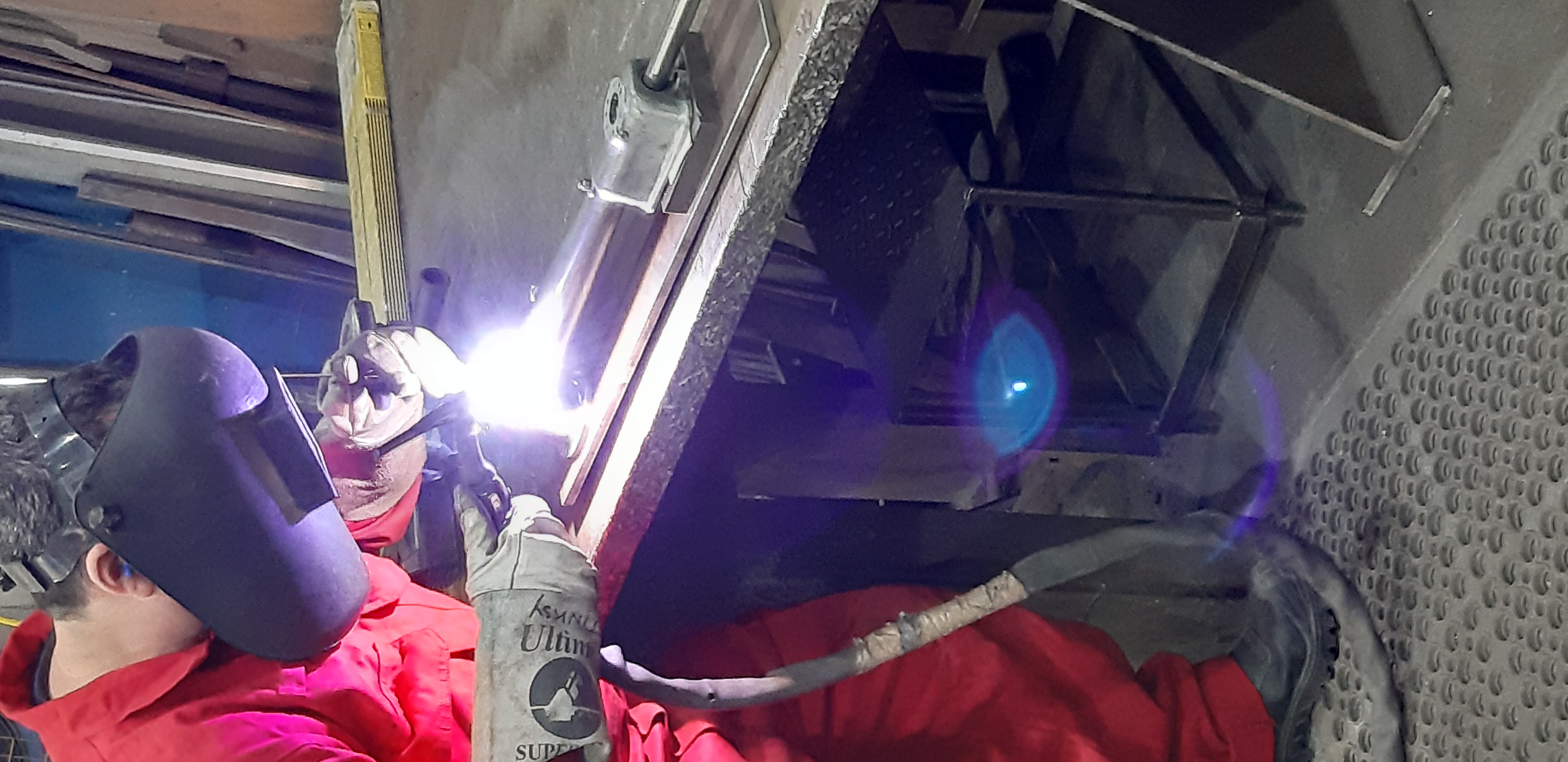

Today in work the welder managed to TIG the two pieces back together. He was surprised how well the weld took to the 90 year old casting. My jigging did the trick and we maintained alignment. I now need to carry out some dressing of the repair, as well as reinstating the grease point. The original grease nipple was right on the fracture line, and has been lost in the welding process
Re: IA 9142
Outstanding Alistair! You have saved a particularly rare part.
