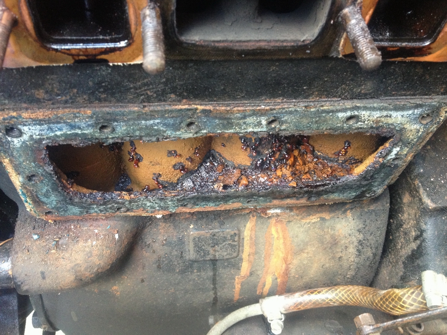

Here's what I found when I removed the nearside water jacket:
Clear around the water exit, but piled up thick round cylinders 3 and 4. Of the 14 securing screws, three sheered off in the threads and will have to be drilled out. I'll run a 1/4" tap through the holes to see which threads are good, but may have to tap some out to 7 mm. Next will be to remove the plate from the other side.

Progress! Fitted the new nearside water jacket sideplate today and now the engine is watertight. First, I had to clean out the pile of rust inside - see the picture above. Much of this mass was so solid that even some gentle hammer and chiseling wouldn't break it up - so I decided to let sleeping dogs lie unless I broke through to the sump! I cleaned off the old gasket which was cork - not rubber, and was almost certainly the Cowley original. I also tapped all of the holes to clean up the threads, so the new bolts would screw up without any problem. The new Sports & Vintage plate went on well with a new rubber gasket and some bathroom caulking goo. Filled the radiator and not a drop coming from anywhere - phew! I fitted stainless washers all round.

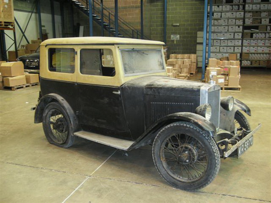

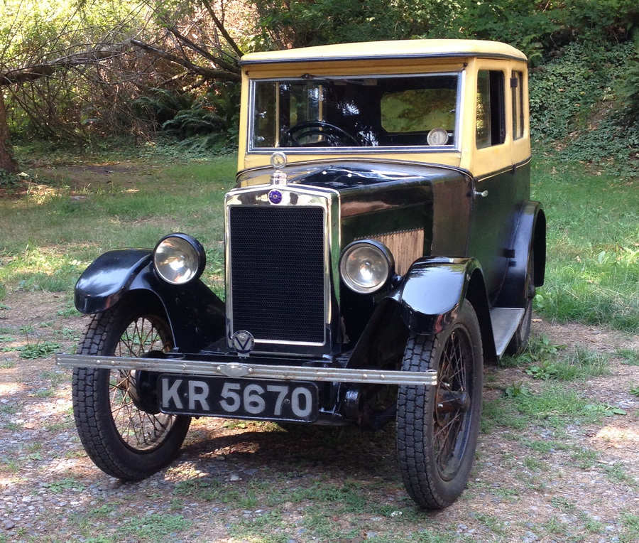

KR is responding very well to some painstaking and careful cleaning and detailing. Lots done, lots more to do. The interior likewise.
In between sessions, I'm driving the car up and down the drive - dozens of times - not yet insured (and not licensed in the US either), so currently limiting it to our property. Its starting instantly on the button and without any need for tickling the carb. Ticks over and runs like new!
Compare the photo below with earlier photo of the car just prior to shipping from Colnbrook, below.
