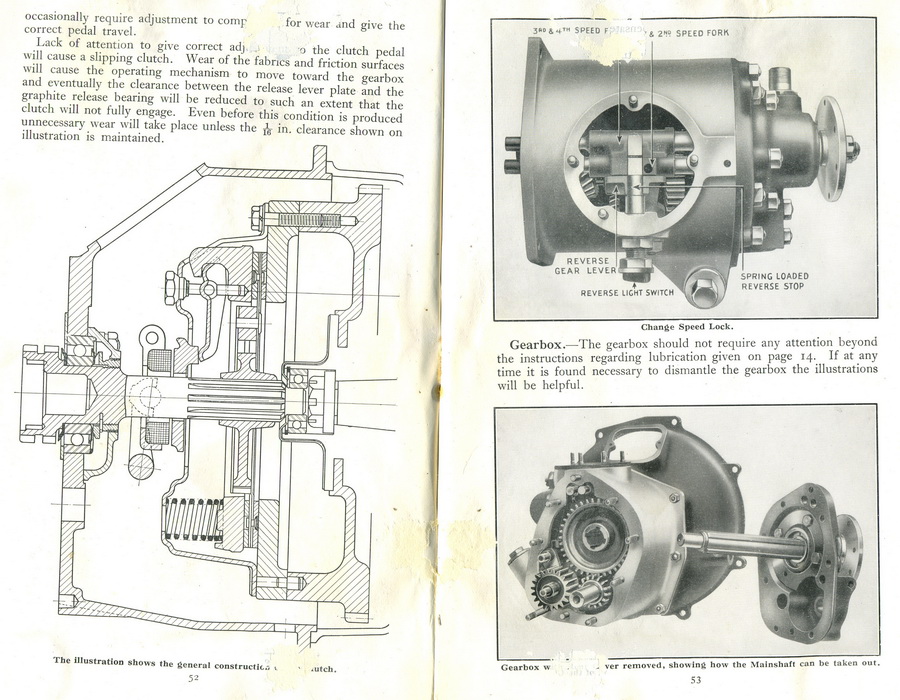

Here's the 1933 Hornet gearbox. The extract is from the Hornet Instruction manual, print date April 1933.
Unfortunately, the printers heavily touched up the photo, removing the numbers we're interested in!

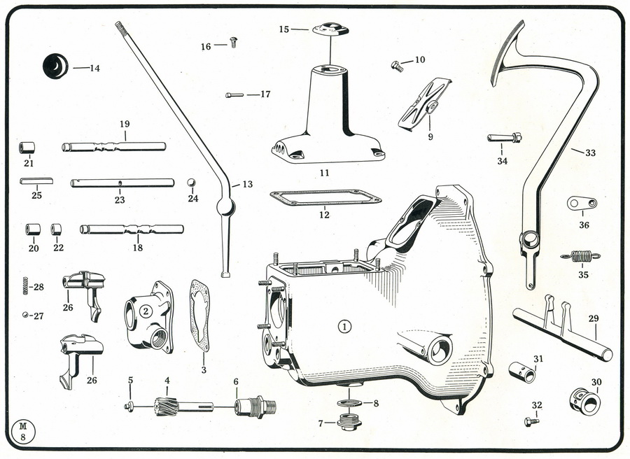

And here's the earlier one-piece Hornet box. This taken from the Hornet Spare Parts List, print date August 1930.
