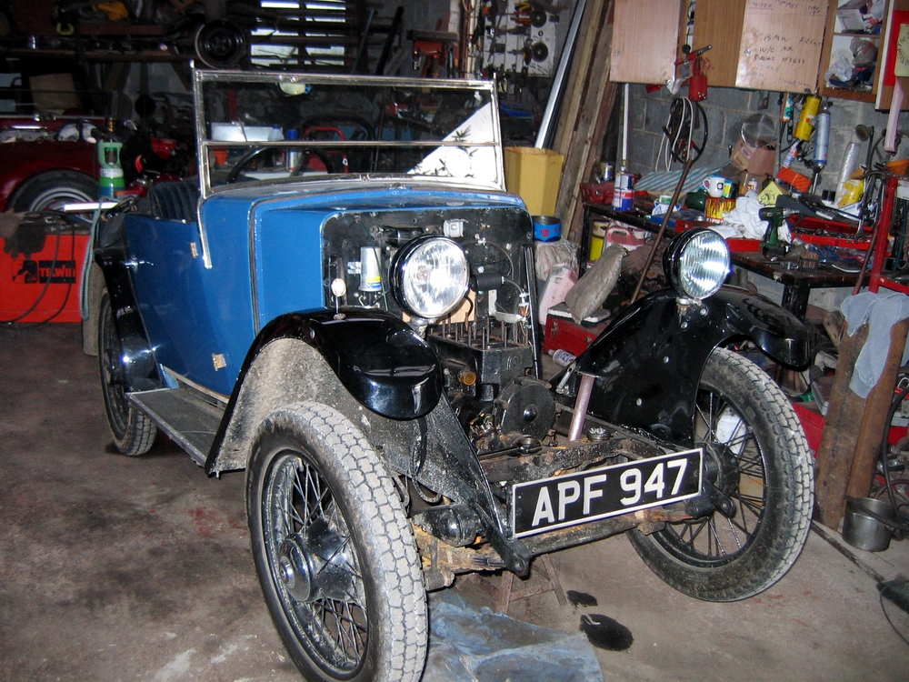

Here she is - with head removed to sort bent rod and shattered piston (just visible on the front cross-member) - probably due to little end pinch bolt going AWOL.
Thanks to Sam Christie for taking this photo earlier today. I have plenty more if anyone is interested.
Re: SV 2-seater opportunity?
The top looks better than the chassis!! Highlander.
The chassis so far as I could tell is absolutely fine and the apparent roughness in the picture is simply honest dirt .The owner has left the car with a friend who has been assessing the engine damage and I was allowed to see the car at very short notice.There is certainly scope to clean and paint the chassis but what I saw looked sound.
I am no engine expert but there is damage to the bore where things went wrong and a set of liners and new pistons and a rod and white metaling would seem to be the immediate needs. In short it would be reasonable to think in terms of giving the engine a complete rebuild. I believe the owner is realistic about this.
