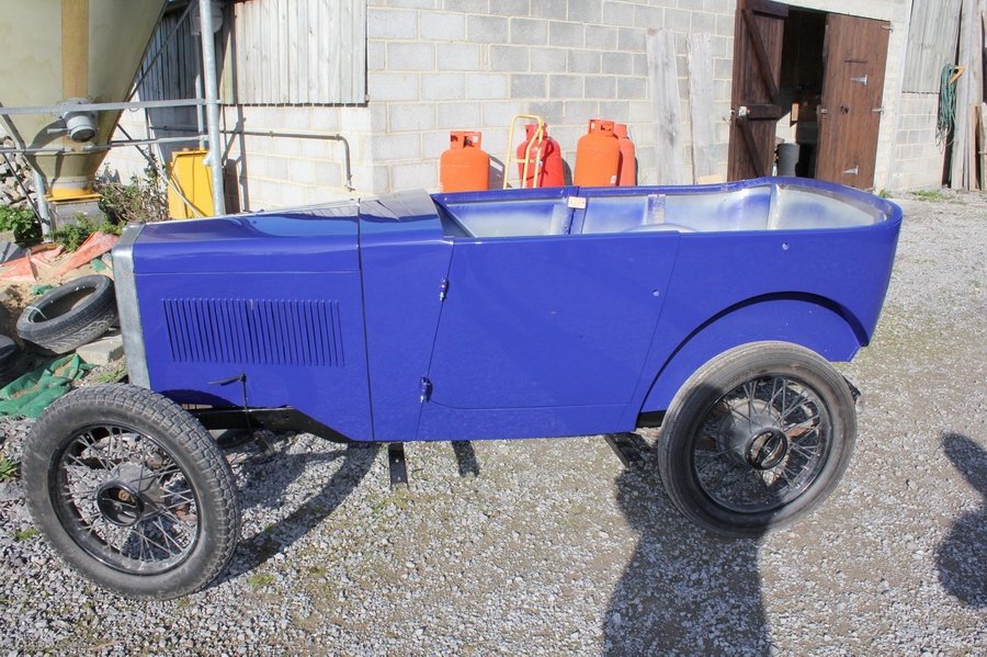

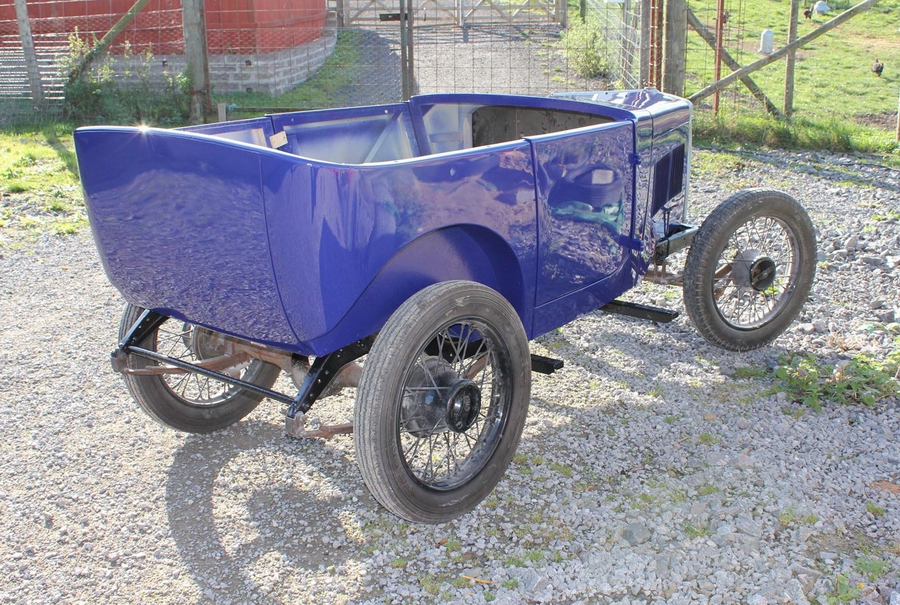

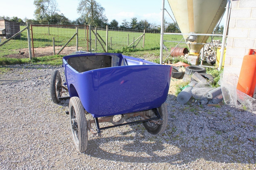

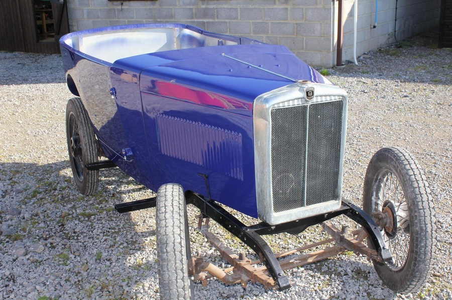

we are getting somewhere!
Re: UX9251
Looking superb Toby! :D
Re: UX9251
Body done, I am assured the blue is darker and matches the swatch I supplied...
Now have to fit new kitchen at home in order to clear out garage so I have somewhere to put it!!!
Re: UX9251
Toby,
The shackle at the rear of the front spring (bottom photo) does not look right. It looks too long and made of of two plates instead of a "U" section. I hope I am wrong.
Re: UX9251
And the front brakes leave a lot to be desired!
