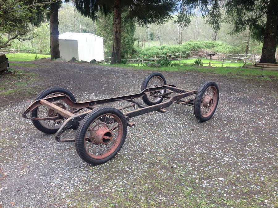

One of mine is to get on with the restoration of the McEvoy this year. The car has been here for about three years now and last year I pulled it completely to pieces, which was a necessary first step to restoration in this case.
I could start by having the chassis blasted and then start building up the rolling chassis - but that's all the easy work, and even when at a rolling, or even driving chassis stage, that's only a fraction of the total job, and the easiest fraction at that. On top of that, if I restore the chassis first and then use the frame to jig the ash frame, the chassis will need restoring again when the body is done!

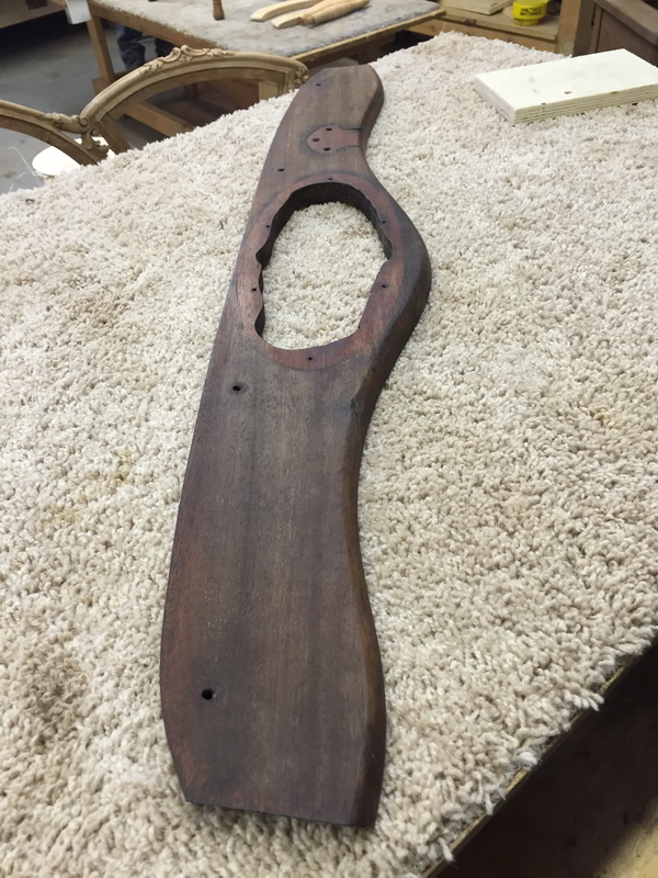

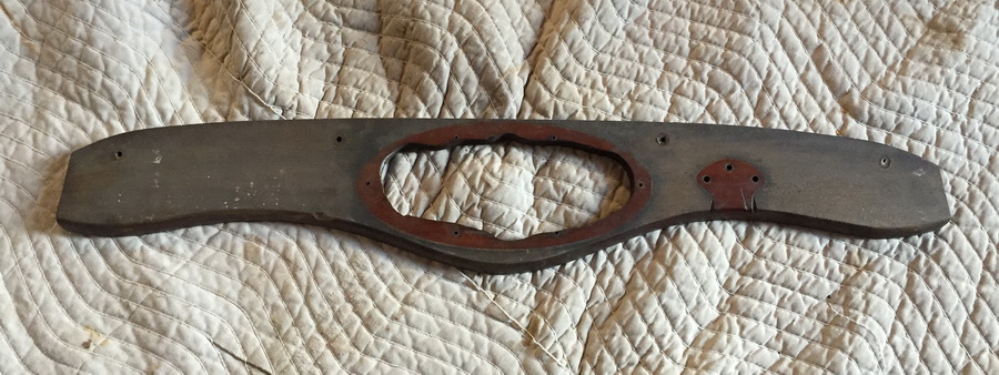

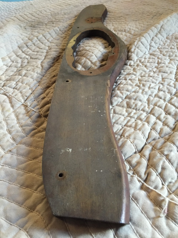

This morning I took the instrument board to Brian Sullivan for restoration. It is in excellent original condition with no extra screw holes, but the varnish has faded over the decades, as witness the un-faded area under the steering column bracket. Just a small scuff under the left side. Brian is a high end furniture restorer and here's his analysis of the board:
"The McEvoy instrument board is of Honduras Mahogany. The wood has been grain filled prior to finish. The small dents to the left side of the bottom edge can be steamed out I think. The color original is Natural Red Mahogany and most likely a varnish. We could do a high end yacht varnish as I plan for my own P-type which is probably the proper historic finish. There is so little damage to the original wood that little else other than finishing is needed."
So I gave Brian the go-ahead to restore. I'll post before and after photos here when I get it back. The instrument panel itself is going back to England for restoration shortly.

The before photo. The after photo to follow soon!

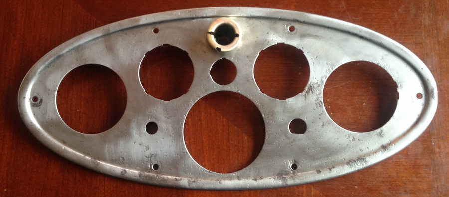

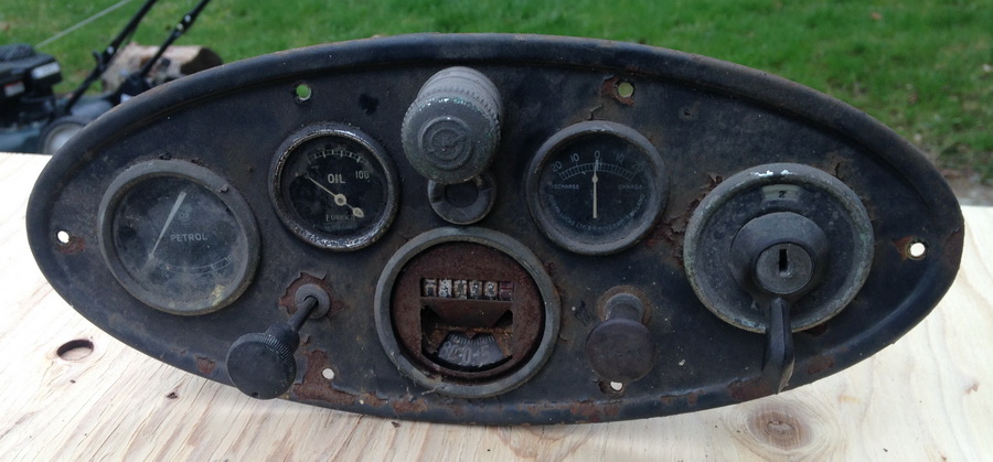

While the instrument board is away being refinished, I decided to tackle the panel itself. I was thinking about sending it off to one of the professional restorers in the UK, but I have decided to have a go myself. That way I can probably save more of the small, original parts. And I'm looking for something with a bit of patina rather than completely overhauled and new-looking instruments.

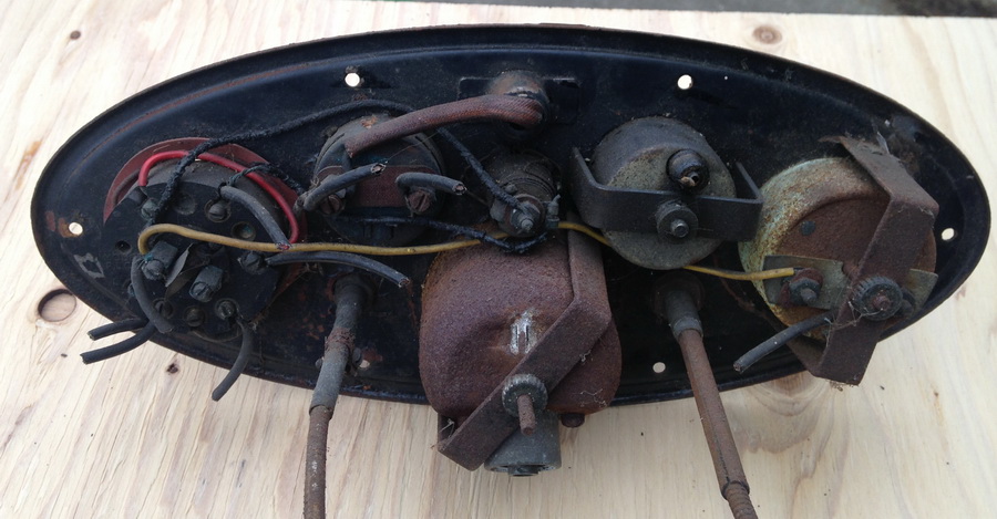

The panel is in a bit of a sad state - see below - but under all the filth and decay, it is 100% original and complete.
The only difference between a standard SV Minor panel and the McEvoy panel is that the slow running control on the right side of the panel has been replaced by a starter cable and pull knob that connects to a relay switch on the firewall. This was an original McEvoy modification. (As far as I can see, there was no slow running control on the McEvoy.)
The speedometer is definitely beyond restoration, but I do have a sound replacement. After cleaning up the front of the PLC2 ignition switch I now know that I need an MRN 27 key.
Some of the original varnished cotton wiring was still in place, but interestingly, there were a couple of lengths of plastic-covered wire. Since the car has not been on the road since 1957, I'm wondering when this wire became available.
The next step will be a few coats of primer filler to fill the corrosion pitting, and then the finish coat.

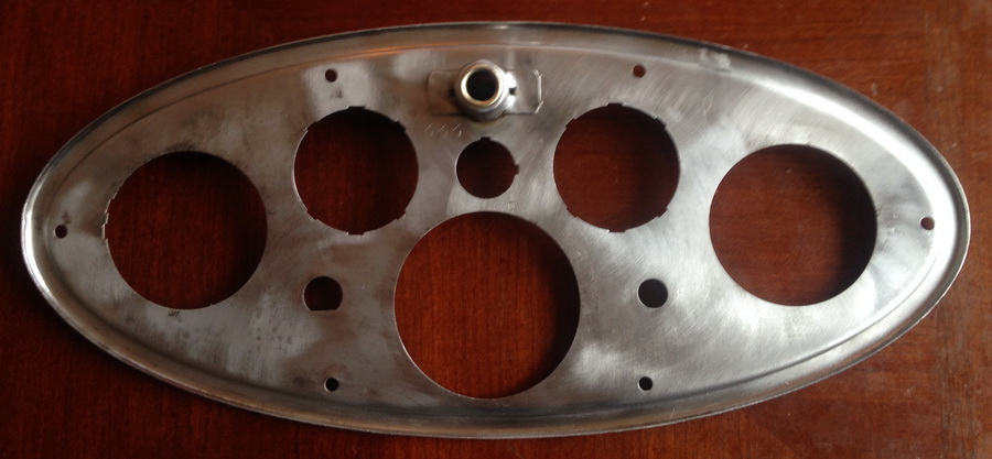

And here's the panel stripped and cleaned up:
And the reverse showing the stamped number 333 and the letter D just above the speedometer hole.

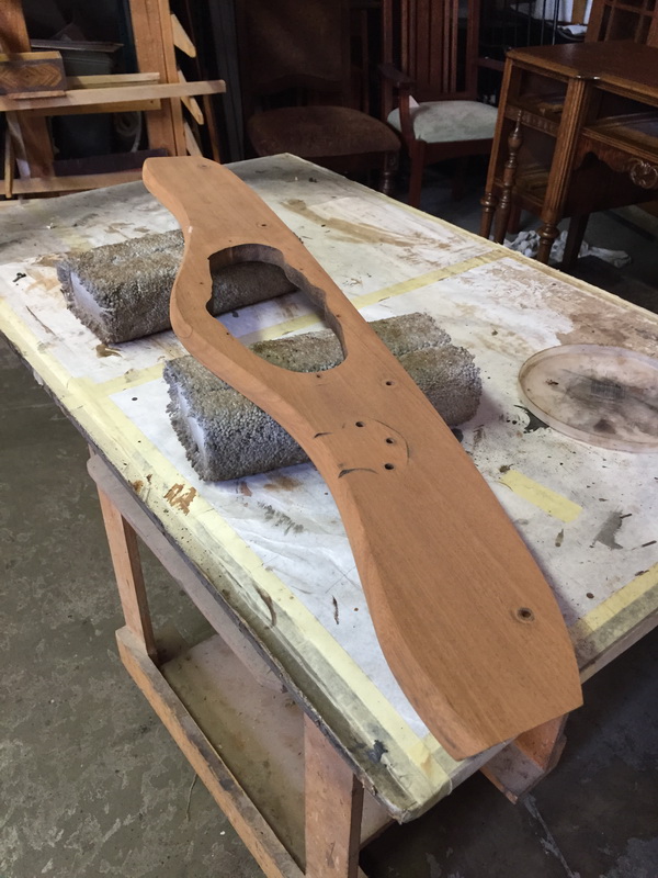

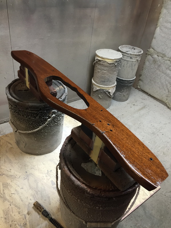

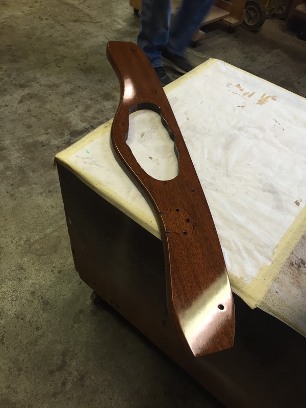

Here's the instrument board as Brian Sullivan progresses through the restoration of the finish. He reports, "We have stripped the original finish,(such as it was). We repaired the gouges at the left bottom edge of the board. The wood sanded to 220 grit surface, grain was then filled twice with matching color grain filler made in the shop. ( Note: whitish discoloration on stripped face shows previous use of grain filler on the board face). Filled board has now had three coats Epiphanes Yacht varnish in place and starting to look good. The coats will be sanded out to smooth between coats ( four more minimum to go) then final coatings will begin."

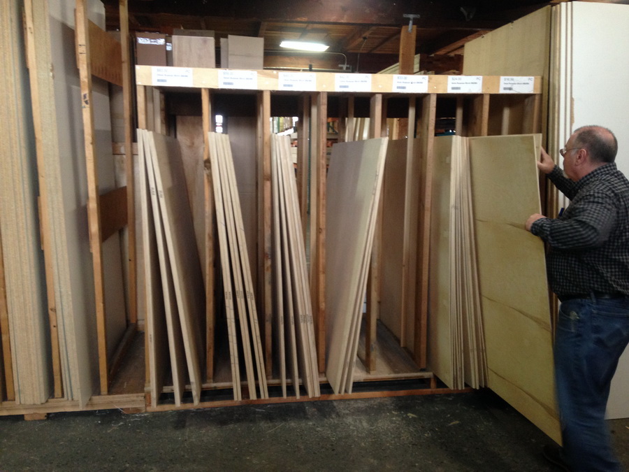

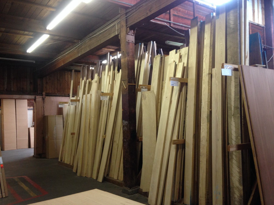

Meanwhile, I visited Crosscut Hardwoods in Seattle today - an incredible emporium that stocks every hardwood imaginable - including dozes I have never heard of. They also have a great supply of Russian Birch ply - perfect for the McEvoy floor
Here's their American Ash stock:
And here's their birch ply:

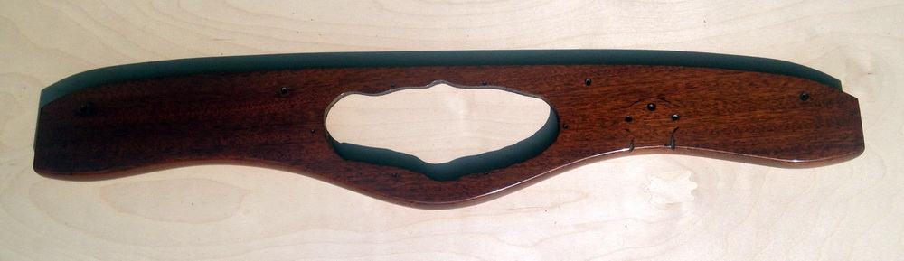

More progress. The instrument board is back from Brian Sullivan's workshop and looks super:

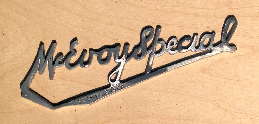

And I collected the McEvoy radiator script while in England. here it is as a rough casting before fettling:
Now that I have the radiator script, the next job will be to ship the radiator to England for a full rebuild. I'm also sending the windscreen over to Wessex Workshops for restoration. I'm trying to get all the 'big tickets' jobs out of the way!

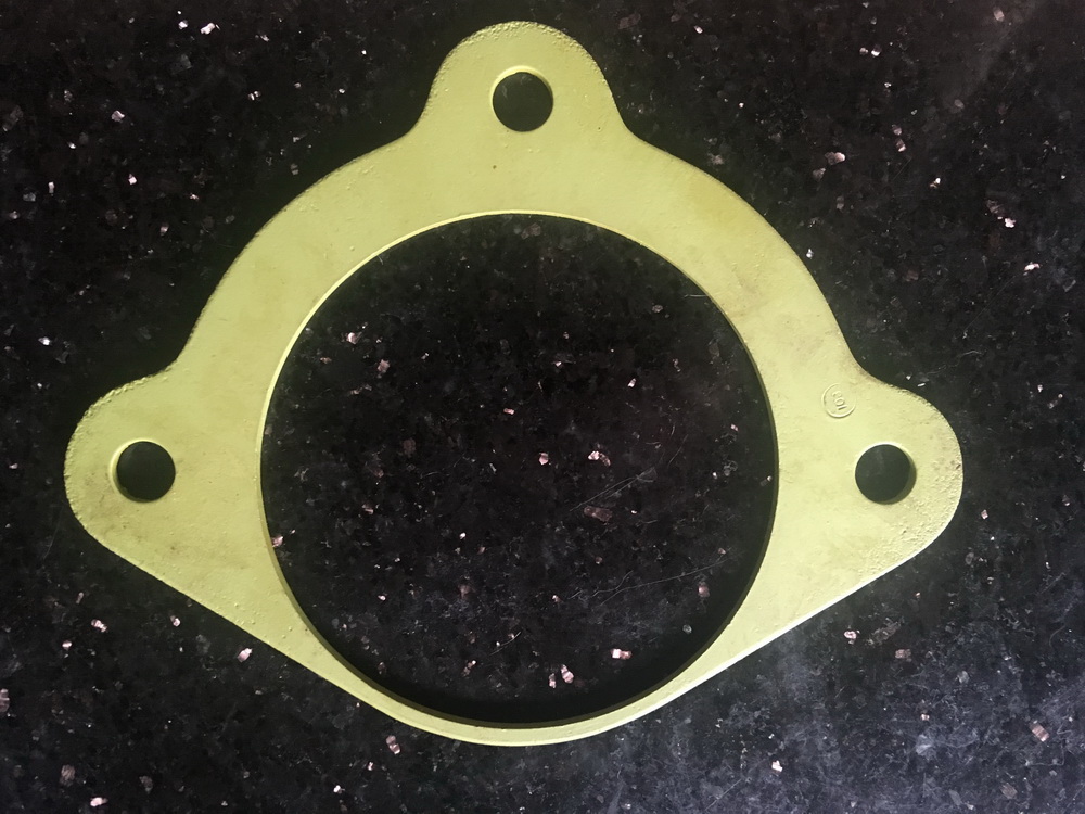

Harvey Pole kindly sent me a starter motor spacer ring which was one of the parts I was missing. Thanks Harvey!

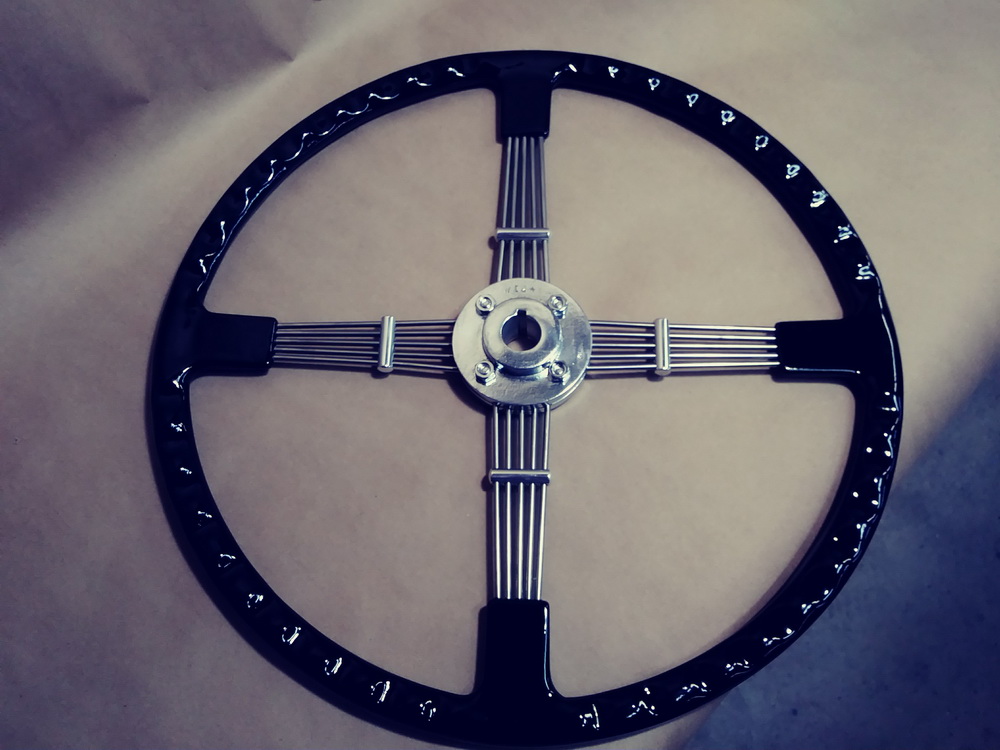

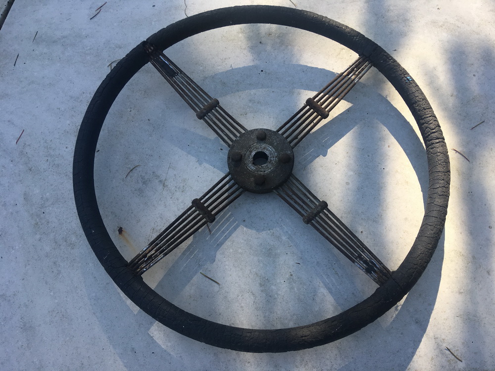

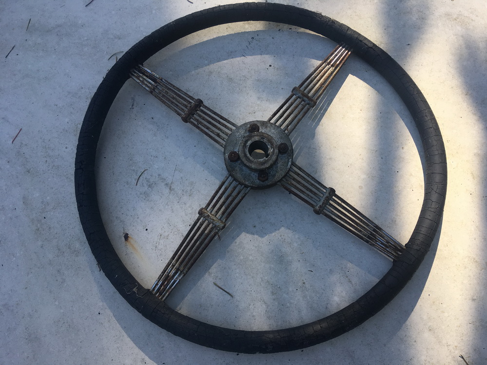

And here is the original Ashby steering wheel which I was going to replace with a new item, but on reflection and close study, I'm hoping to have restored. The end result might not be as shiny as a brand new one, but it will be the original wheel to the car.

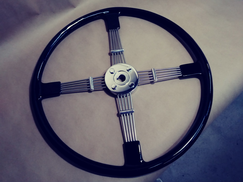

See two posts up for the unrestored steering wheel.
Here it is after expert restoration by Ben Cordsen. He has done a fabulous job, using all of the original components.
