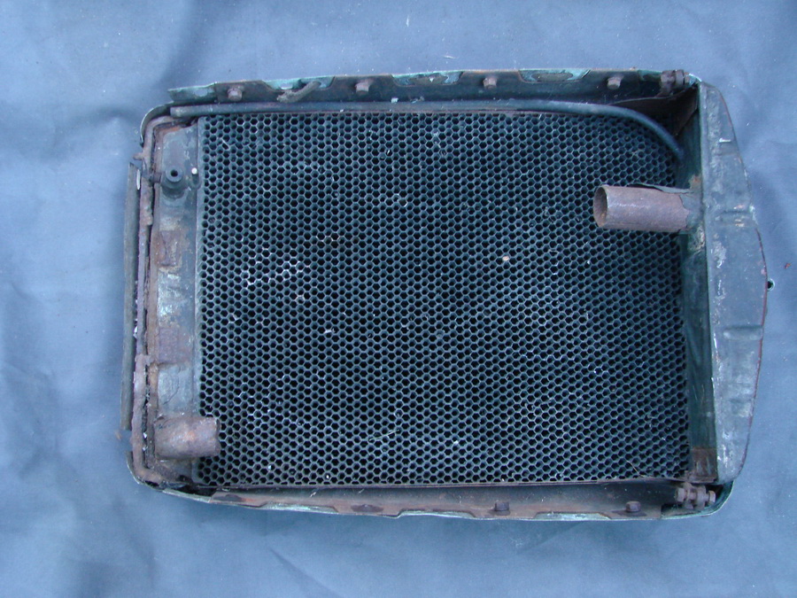

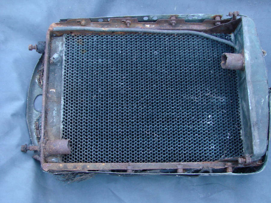

Tonight I dug out the two radiators I have for this car. See below.
The top one is the radiator that came with the car - with a 1933 radiator shell fitted. On close inspection, this radiator turns out to be a 1931 season Flatnose, straight-sided radiator that has been cleverly fitted into the more rounded 1933 shell - see the spacers. But also notice that the holes for the attachment screws don't line up with the holes in the earlier radiator sides! This can also be seen by the misalignment of the holes for the radiator tape. So the whole thing turns out to be a bit of a bodge.
The second radiator is a standard 1932 radiator, which should be the same core as the 1933. But also notice the marked difference in the length of the top water outlets. The 1932 radiator seems to have been modified at some point with a longer top outlet jammed inside the broken remains of the original!
Although the cores of both of these radiators look sound (I haven't filled them with water yet), the steel parts, and in particular the steel feet, are in very poor condition.
If anyone has a better 1932/1933 radiator (like the lower one below), less shell, then I'd be very interested.

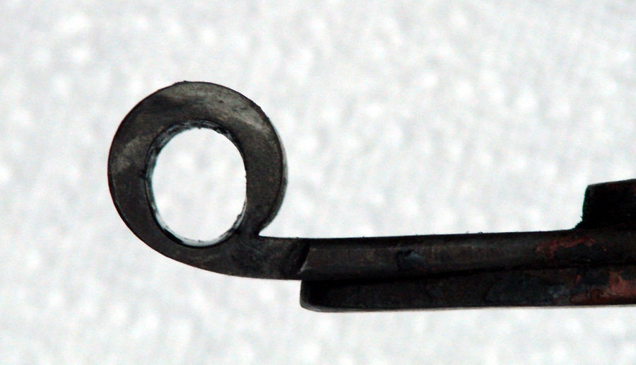

Does anyone have experience repairing/welding road spring eyes?
Yesterday I cleaned up both McEvoy front springs, with plans to fit them to the fabric saloon, as the fabric saloon's front road springs are very flat. Then re-temper the fabric saloon springs and fit them
to the McEvoy once the body is sorted.
The good news is that the springs are stamped April 1933 and May 1933 which tie in perfectly with the build date for the car of 25th May 1933. That got me thinking that they should really remain on the McEvoy - as they are not generic.
The bad news is that, although one of the springs is virtually perfect, the other has both eyes badly worn (can't remember which, but probably the gutter side!) - to the point that there isn't much metal left to support the car!
I may fit them to the fabric saloon short-term anyway, just so that I can keep it mobile while I have its springs re-tempered. So I'm now on the hunt for a local road spring guru here in Seattle.

One solution would be to make a new main leaf from a rear spring leaf as there seem to be many more rear springs about than good front springs. There must be people who can make springs in the USA !!

Thanks Simon,
That's a good idea regarding rear springs, but I don't have any spare rears here. But I should be able to have a new main leaf made, although I'm not sure which is more work - to pull the spring to pieces, including opening up the bent-over clamps or to weld and machine the eyes in the existing leaf.
I have put the word out locally this morning to find a local spring restorer.
Interested in your thought that fronts wear worse than rears, as new rears are available (same as the M), but fronts are not (the M front spring is flatter). If there was sufficient demand, it would be good to commission a batch of new fronts. Any interest?

I suggested using a leaf from a rear spring is because they are imperial size ( which I am led to believe is difficult to get hold of) and the leaves are held together with clips and through bolts. I seem to have acquired two extra sets over the years. Perhaps it was with the SV Minors that Morris started to use fold over type clips to save money !!
Front spring rubber buffers were available from Harry Edwards so I expect Ian Harris will keep them now.
If I get time I will see how many front spring main leaves can be made from a rear spring.

Thanks for that Simon. I will look in to sourcing the necessary leaves and may well get them cut/ends rolled in the UK - easier to find someone over there to do the work (any suggestions?) and the shorter they are, the less the postage will be! The SV spring clips would be simple to replicate if they break when opening them. On these springs, at least, they are simple steel strips with an indent that lines up with an indent on the topmost leaf to locate them.
The rear leaves may also need curving a little more to match the front leaves too.
