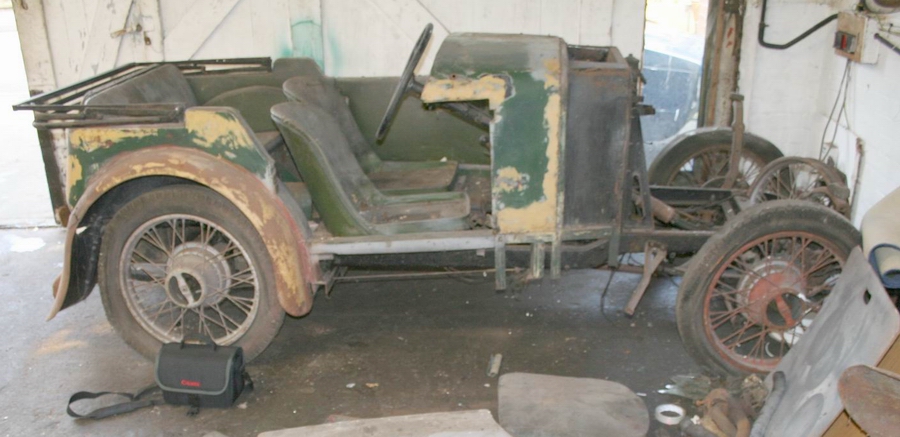

I have just received from Bev Hicks his article for the Yearbook on his McEvoy which he owned back in the sixties. In it he mentions that he has a letter from the previous owner - a Geoff Perrin - in which he mentions that he once met up with another McEvoy from the Cambridge area, and that this was painted cream. On the photos of NV (see below), the cream colour can clearly be seen under the more recent green. The car was last on the road in 1957, and since Bev acquired his McEvoy in 1961, then Mr. Perrin must have seen it some time in the mid to late fifties. Small world!
As for restoration plans, as mentioned before, I had planned to fit a 1932 season radiator and delete the rear valence. On second thoughts, I think I will keep it perfectly original to the 1933 specification, which means that I will need a late-pattern front valence (the car has none at present). Can anyone help?

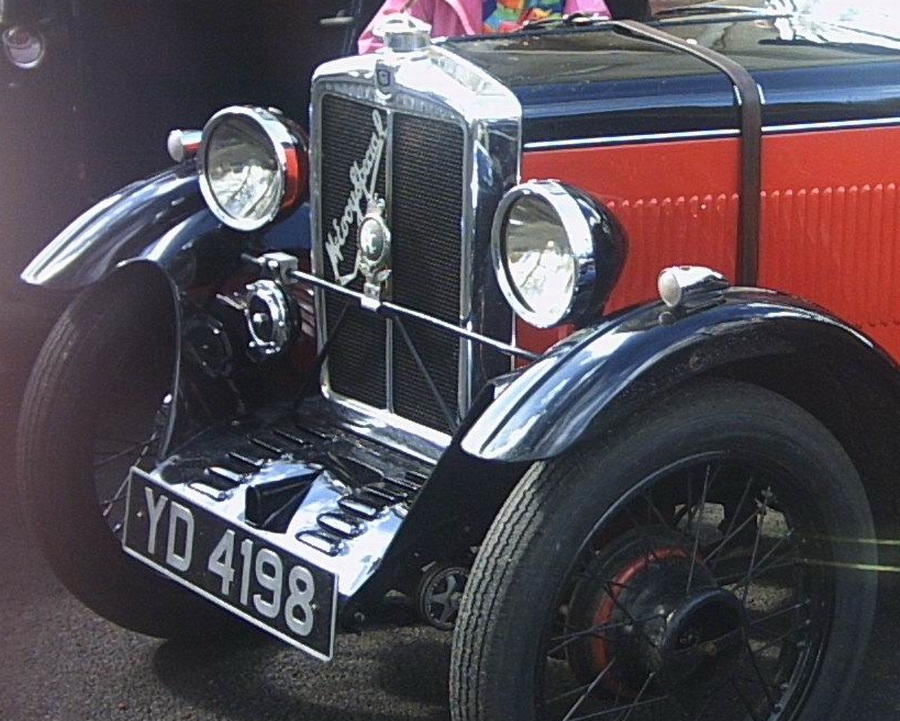

Mine is a 33 Jensen, or at least parts of it. Would you please check the chassis number against your records. I have got what I think is the correct front vallence, but it needs to be checked with the correct side valve radiator. Over to you. Is anybody thinking of making front vallences for cammy Minors.
Re: NV 2803 - 1933 McEvoy Special
Hi Simon,
Your Jensen's (which may be a McEvoy) chassis number is SV31636 which puts it firmly in the 1933 season. The front valence on your car doesn't match any seen on contemporary photos of McEvoys/Jensens.

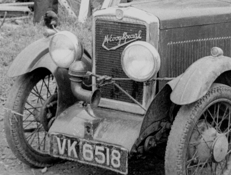

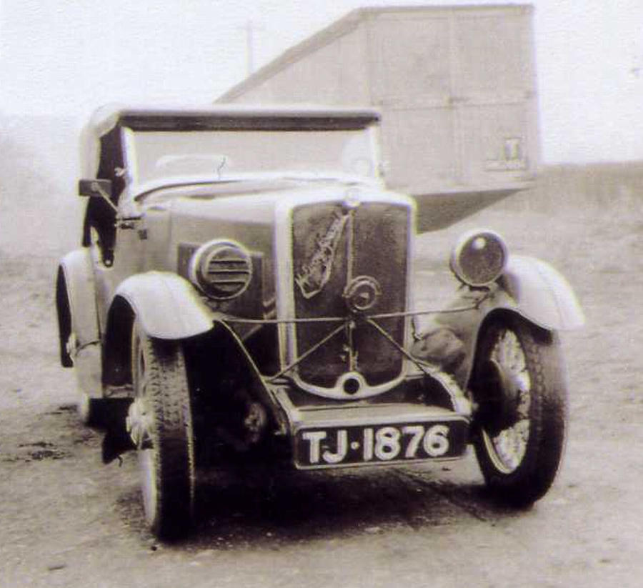

I'll post a wartime pic of the front of the ex-Bev Hicks' McEvoy later today which shows the standard 1933 season Minor front valence fitted, which is what I believe our cars should have.
Well, this is interesting. I just scanned and blew up the image of Bev's McEvoy, clearly taken during the war. It is difficult to see clearly, but from this image, I can't rule out the possibility that the valence currently fitted to your car is indeed original. We know that the 1932 season McEvoys had custom-made louvered front valences fitted, so there is no reason to suppose that they retained the factory valence for the 1933 cars. And also, although your car has been fitted with a vintage radiator for decades, your valence is clearly made to suit the 1933 season radiator shell which dips down below the front cross-member.

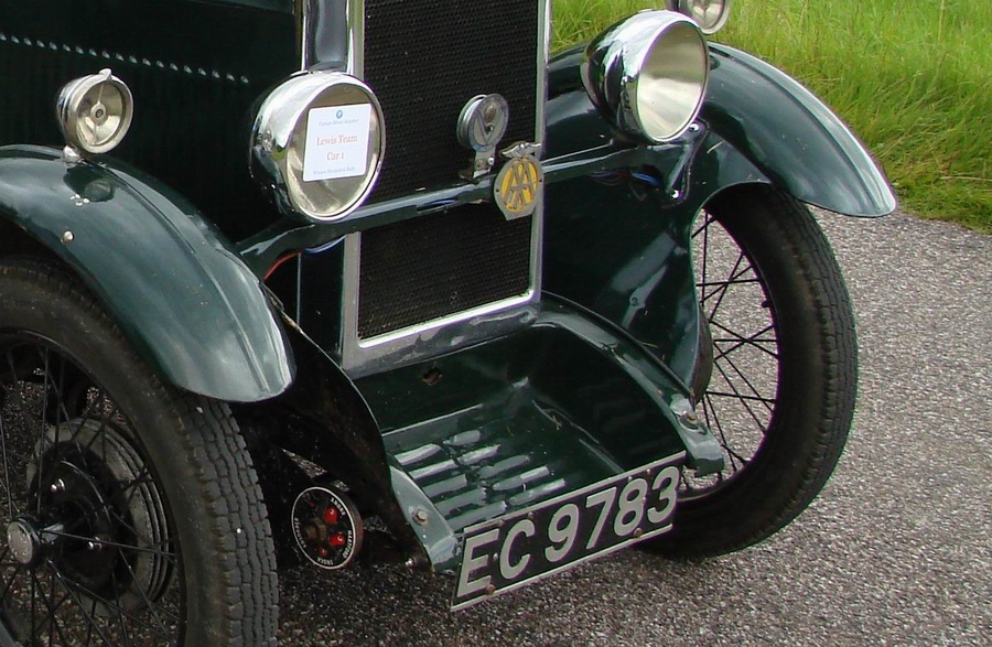

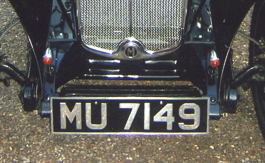

For comparison, here is the stock 1933 season front valence:
It looks very much like the wedge-shaped fillets inside the chassis rails of the stock valence are absent from that fitted to Bev's car. Conclusive?

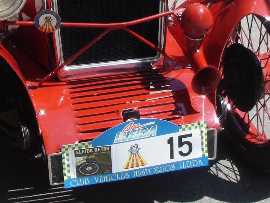

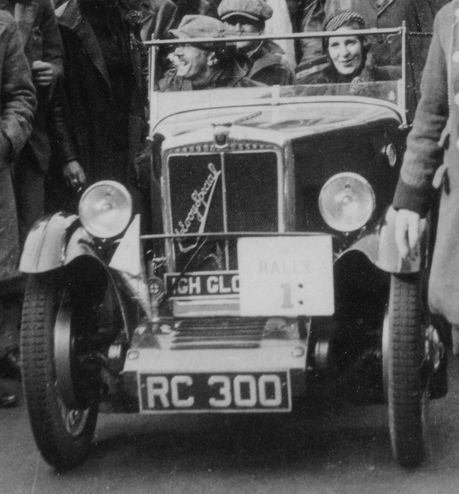

For completeness, here's some more McEvoy/Jensen valences.
First, the prototype 1932 car RC 300 - clearly a non-stock valence:
Next is Jim Peacop's 1932 car:
Next is Sarah Gibson's 1932 car's front valence back in the sixties:
And the same car today:

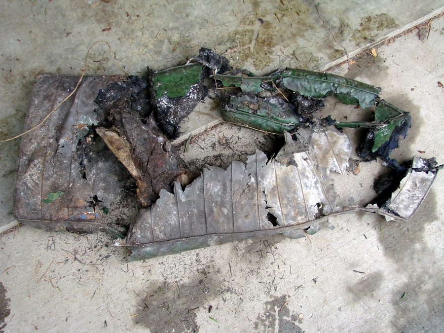

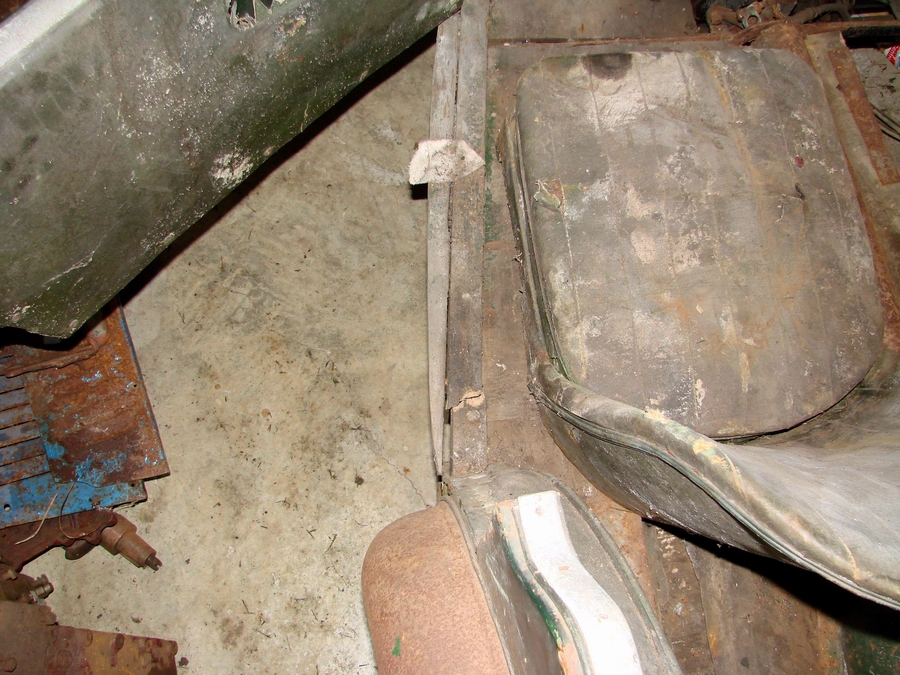

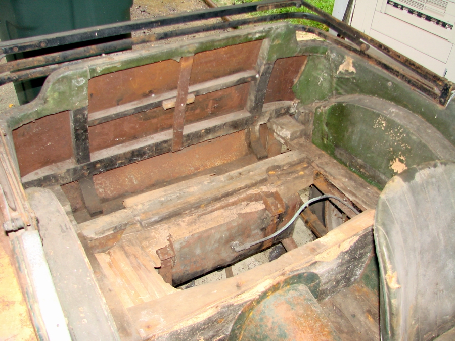

Time for a quick update on the McEvoy. Today was the first chance I have had to take a good look at it. The first task was to clean out the body which was awash with the debris of decades - 54 years in less than ideal storage, to be exact - she was laid up in 1957. Hundreds of snail shells filled the foot wells - evidence of much fine dining by the resident mice who had done a good number on the rear seat squab. it looked quite presentable before shipping, but six weeks of vibration destroyed it to the point of being almost unrecognizable. What seemed to be the remnant chunks of horsehair turned out to be one massive mice nest and most of it ended up on the garage floor because the underlying ply board disintegrated.
The cleaned out office showing the hydraulic brake conversion. Amazingly, the inch or so of pedal cross-shaft that was cut off to accommodate the rather bizarre brake pedal box was found buried in the debris in the rear foot well.
A vertical shot showing the broken nearside ash sill rail - possibly another consequence of its recent container voyage and the accompanying weeks of vibration. The frame is suffering from extensive dry rot and woodworm and most - if not all - will need replacing.
What is left of the rear seat squab.
These photos look grim, but they record the low ebb for this car. It is completely original and all the patterns are there - it now has a bright future and will make a superb car in due course.
