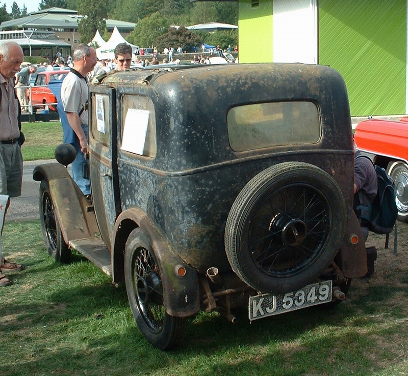

Hi Everyone,I need to see what a 1932 and 1934 back of a minor looks like,
There are plenty of pics of these cars but no one seems to photograph the rear end,
i need to configure my rear lights and other things can anyone help?

Here's a 32/33 saloon rear end showing the original number plate with single TF 201 on the right and a couple of reflectors. You will need two rear lamps to pass the MoT, and many people make up a number plate with two ears - one each side. Does this help at all?

Thanks Ian, 2 ears :? . do you mean another tf201 on the otherside of the number plate?

Sort of - but I forgot to mention that the 201 is also too small a dia. for the MoT, so you need to fit replacements which are available from Paul Beck, I think. They are similar in design, but have larger lenses.

I have seen D lamps on some minors and wondered if this was only on 34s or later, that is why i wanted to see a later rear end (sounds awful doesn't it) :oops:

Dear Col, The one modification I allow myself when restoring older vehicles are the rear lights. Regular readers will know I have a thing about seeing in the dark and being seen! The original TF 201 can be modified and I have somewhere srew on larger lens, these can still be purchased. Ithink they are inch and a half. However if you can get D lamps and fit brake lights I think you will be better off. May I ask what you will do with your headlights to make them better? Lets lighten up a bit, Highlander.
