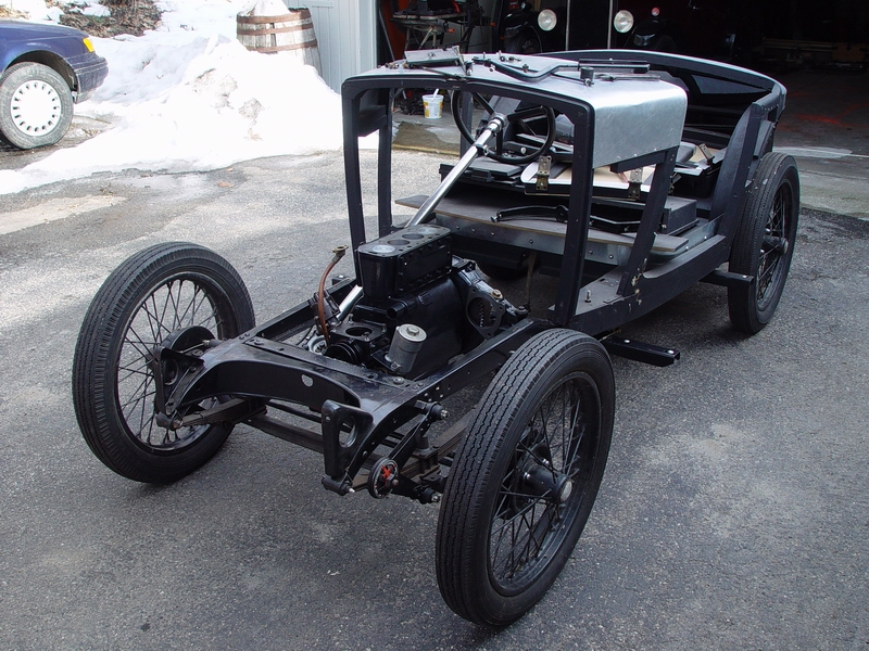

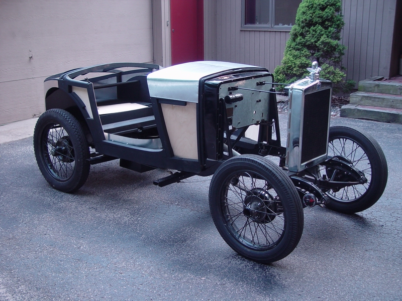

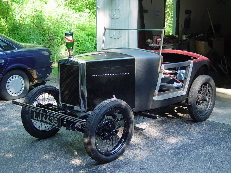

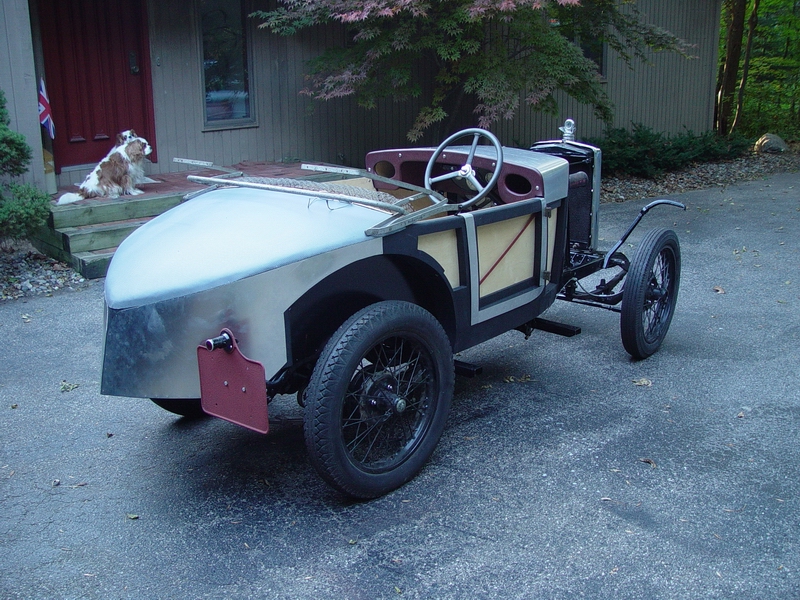

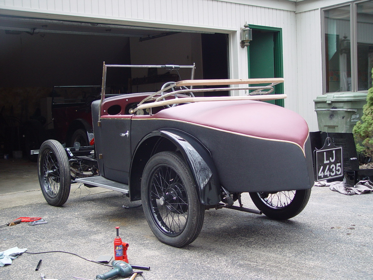

A few pics from the last couple of years - note in pic 2 the snow piled up last spring (and it's back again already!), just as the engine was being installed. Pic 4 was taken moments after the first firing up this spring. The final pic was taken a couple of weeks ago on the second run up the lane.

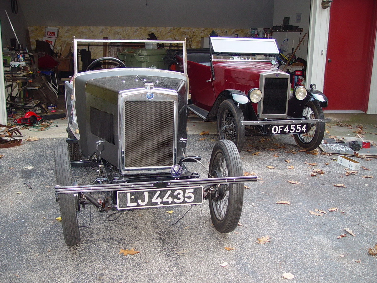

Work progressed well this weekend with the fitting of the new bonnet catches which required the wings to be very carefully drilled to fit the catches exactly in the right place. Amazingly, everything seems to line up - let's hope this remains the case after the wings have been off for spraying, which is the next major milestone.
Work is reduced to 15 minute stints right now, as it is 21 degrees Farenheit in the garage this afternoon, so frequent thawings out with hot tea in the kitchen are vital.
Posts: 5042
Getting very close to completion. Nearside door finished, running board on with new 'Morris' rubber, beading on (will be chromed after the Summer Rally) and first rear wing fitted. Also hood frame completed with new ash bow and hood peak. Bonnet and radiator off to swap dynamos. The new hood will also have to wait until after the rally.

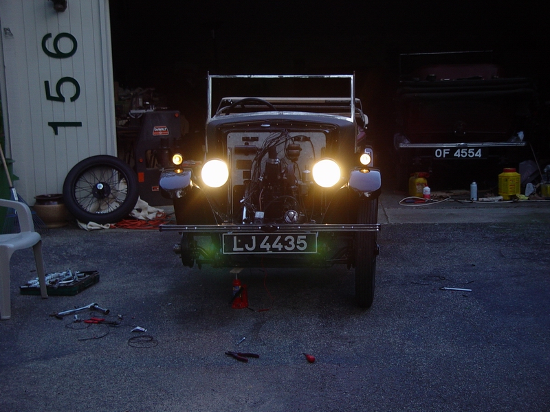

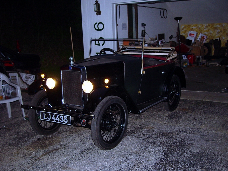

Couple more photos taken tonight after wiring in the lamps. Just threw the radiator and bonnet on before dark - will line up, fit the new bonnet catches and and fill with water tomorrow night.

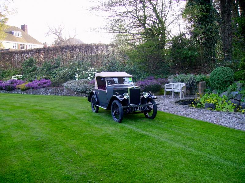

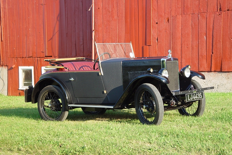

She's now on the road and done about 140 miles with no significant problems. This photo was taken on a run to a local farm this evening. It should go for its hood to be made in a few days and then it is off next week to Baltimore to start the long trip back to England for the Summer Rally.
I can't wait to drive it through the lanes of Dorset, which it hasn't seen for many a long year. While in England it will be staying at the very same house that it spent the war - Milton Manor. Can't get much more appropriate than that.
It is a JOY to drive!

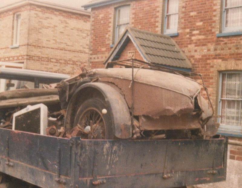

For those not familiar with this car, here's what I started with:

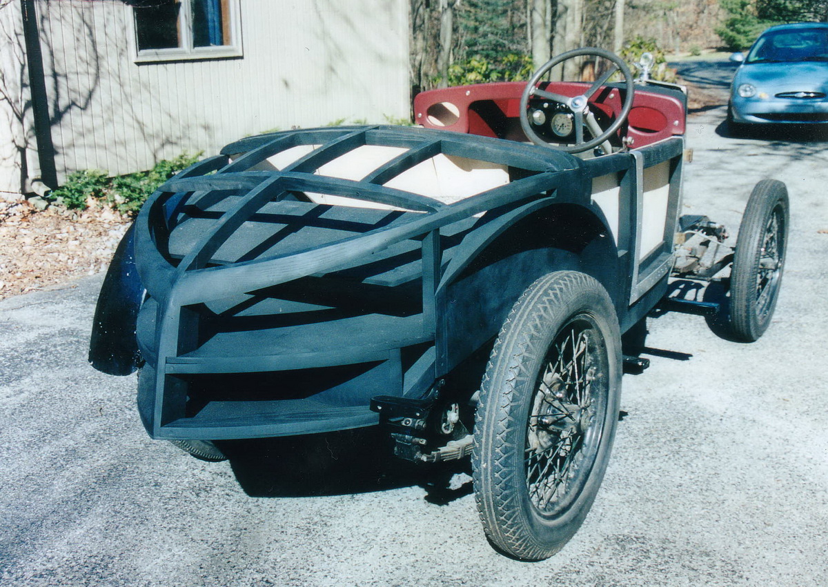

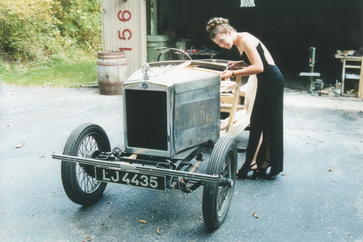

Our daughter Amanda, helping Dad out before heading out to her High School Prom. This was taken shortly after the car arrived by container from England as a rolling chassis. The first task was to build the ash frame, using the original timbers as patterns, plus the ply patterns I had made when previously restoring JN 570 in the eighties. Note the bandsaw in the garage.
The ash frame painted and nearly ready for paneling and fabric, showing off its sweet lines.
First firing up. The car retains its original factory engine that was vandalized in a machine shop in Bexhill, while we were living in Germany. There were two years of delays and excuses. They had found a crack in the block and had to send it to a company in Birmingham for welding - or so they said. The truth, which was discovered by my brother-in-law who lived in nearby Hastings, was that furious creditors broke in to the engine works one night and smashed every engine with sledgehammers. The block was subsequently described as a 'jig-saw puzzle', but some superb craftsmen in Birmingham stitched it back together and the repair is now invisible externally. Luckily it was limited to the side opposite the oil gallery. if that had been smashed, the block would have been scrap. As the Bexhill company quickly went bust, there was no come-back - an expensive exercise, but it did save the original block.

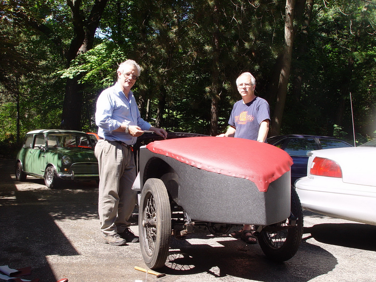

During the fabric work (I chose hot weather so the material stretched over the tail more easily), Register member Peter Caldwell visited from Wisconsin to learn how it is done before tackling his 1931 Minor fabric saloon.

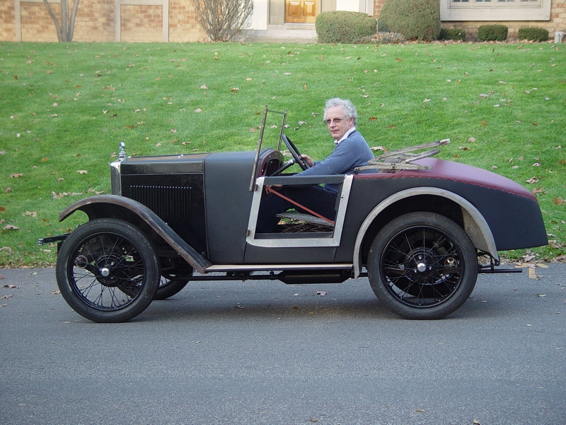

The big day. First drive up our hill and back.

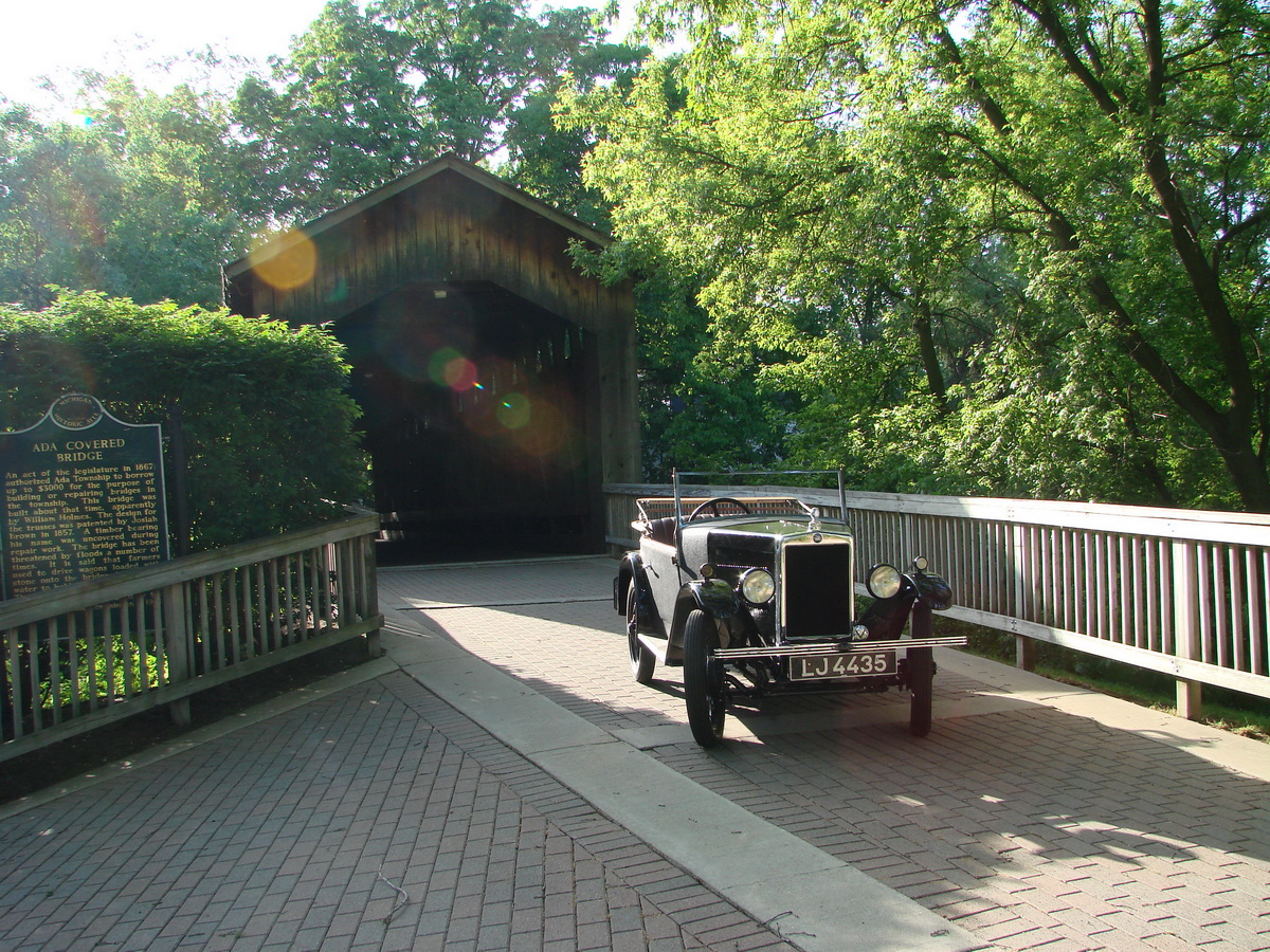

An early test run to the historic Ada covered bridge.

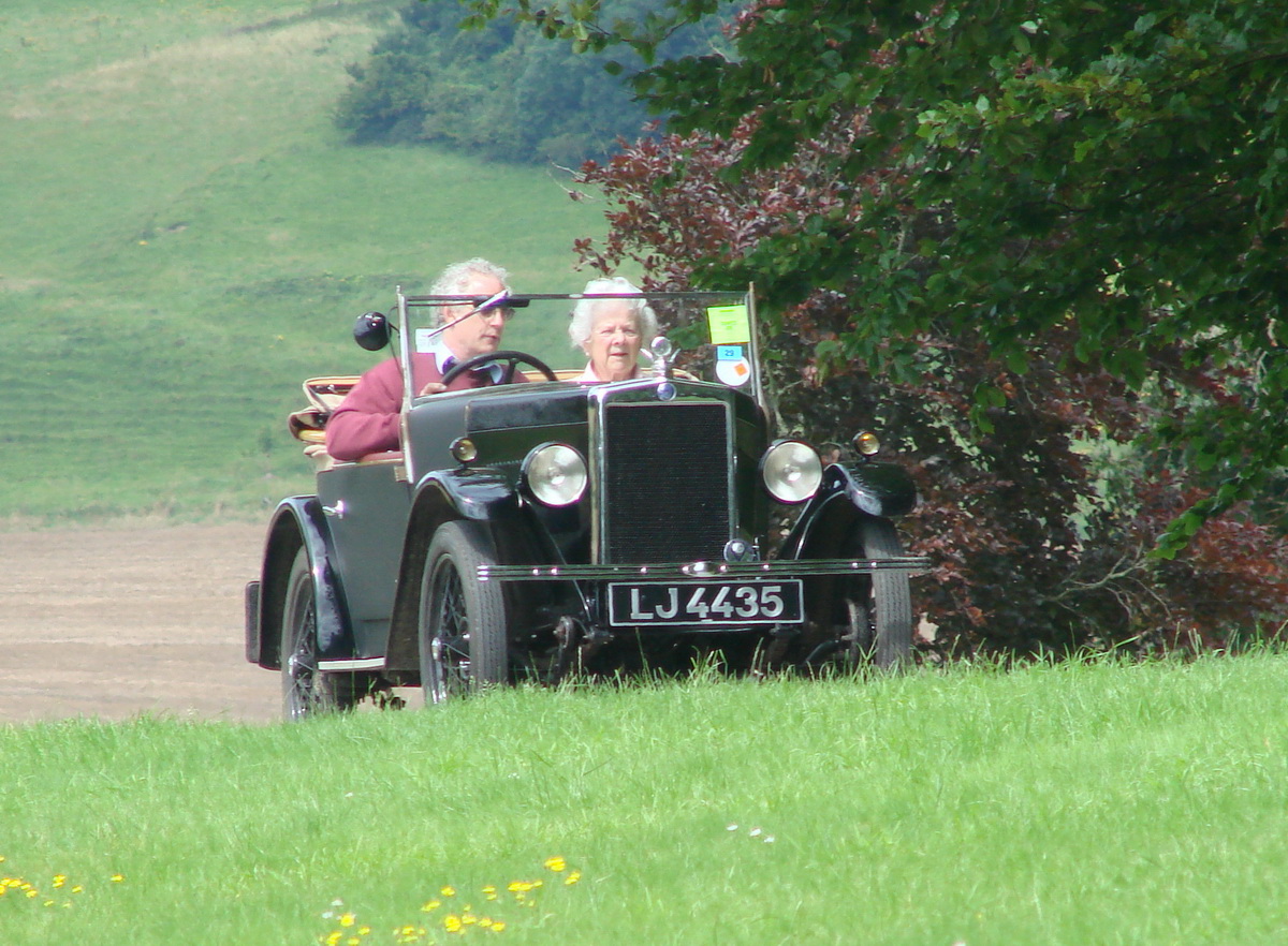

Our Summer Rally at Milton Abbey in 2007, after this historic car had been repatriated. Note the shipping stickers on the windscreen. The green one reads 'TOWED ON'. I didn't want it driven by the dockers! When the car arrived in Southhampton, I was there to collect it and drive it to Dorset. The car was undamaged, but I did find the gear knob missing. I found it on the floor. Weeks of a ship's' engine vibration tends to unscrew anything not tightly secured. The only other problem was that it would not start. The distributor points had become glazed with salt air. A quick cleaning with emery paper and we were off into the Southampton rush-hour!

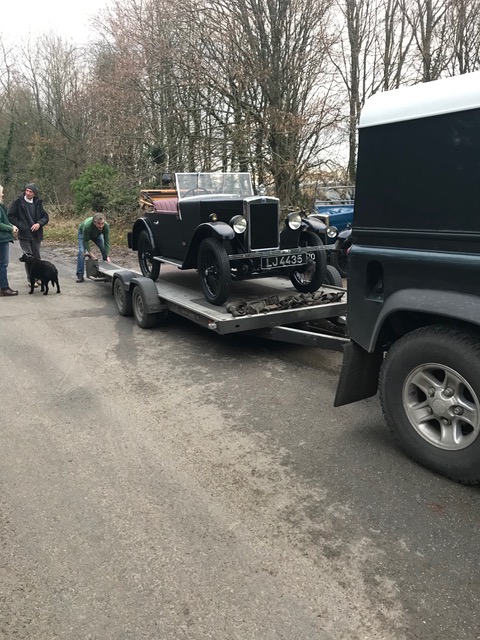

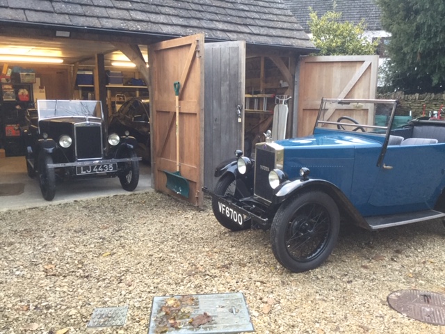

LJ 4435 was successfully delivered from Kent to Tarlton, Gloucestershire yesterday in chilly but dry weather. John Stubberfield was in attendance, arriving in his son's 1929 tourer. Darkness fell before any attempt to start it could be made, and the battery will need a charge first. But it was very pleasing to find that the car remains in the pristine post-restoration state as of 12 years ago. It has not been driven since then and has obviously been very well looked after.
