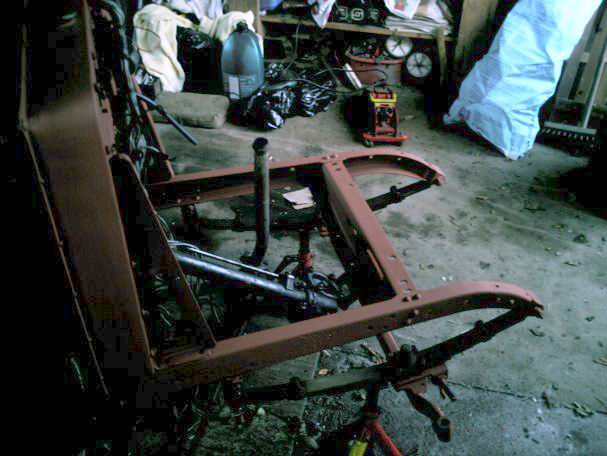

Whilst the engine of DF is out being rebuilt following the summer rally bearing problems, I thought I would do a few other jobs. Perhaps I got carried away!
Firstly there is the kingpins, shockabsorbers and front brakes

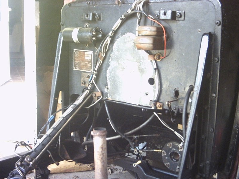

Then the front chassis and firewall may as well have the once over
and then I thought might as well tidy the front wings!
I am sorting the bonnet as well just for good measure!
cheers
Jeremy

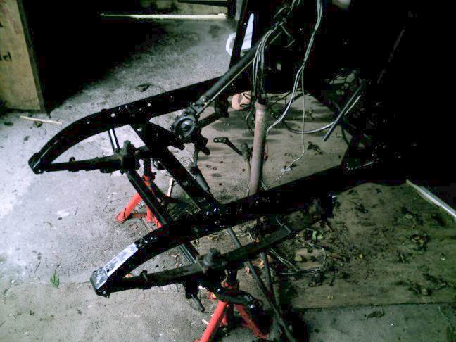

Here are some progress pictures
Chassis in primer ready for top coat.
Top coat looking smart, one more before reassembly, its taking ages to dry with the cold and wet weather - please excuse the leaves all over the floor!

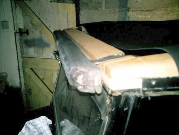

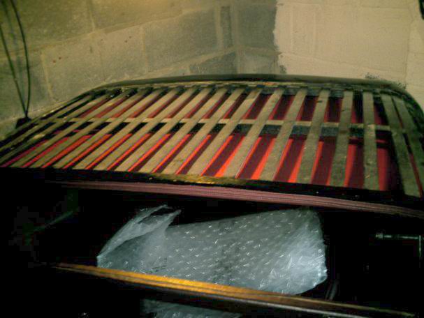

Rear roof structure, the red is the inside of the headlining, there was a felt cover over the strips then the roof material.
This header rail has seen better days, thankfully it does not look difficult to make a new one.
Cheers Jeremy

Does anyone know whether I need to pull the "duck" fabric tight or leave room for shrinkage?
Front to back it is held but side to side, on the opening section, the last roof had shrunk quite a bit.
I have sourced some ash for a new header rail and once this is made hope to fix the material on.
Many thanks
Jeremy
I would give Dave Cooksey a call. He's going to be doing my hood in the spring. 01264/771857

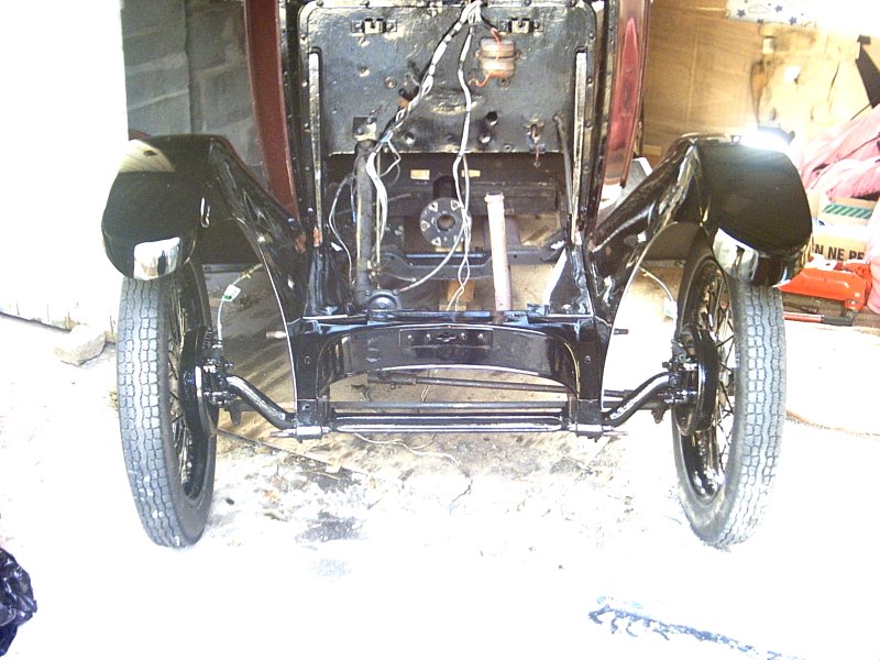

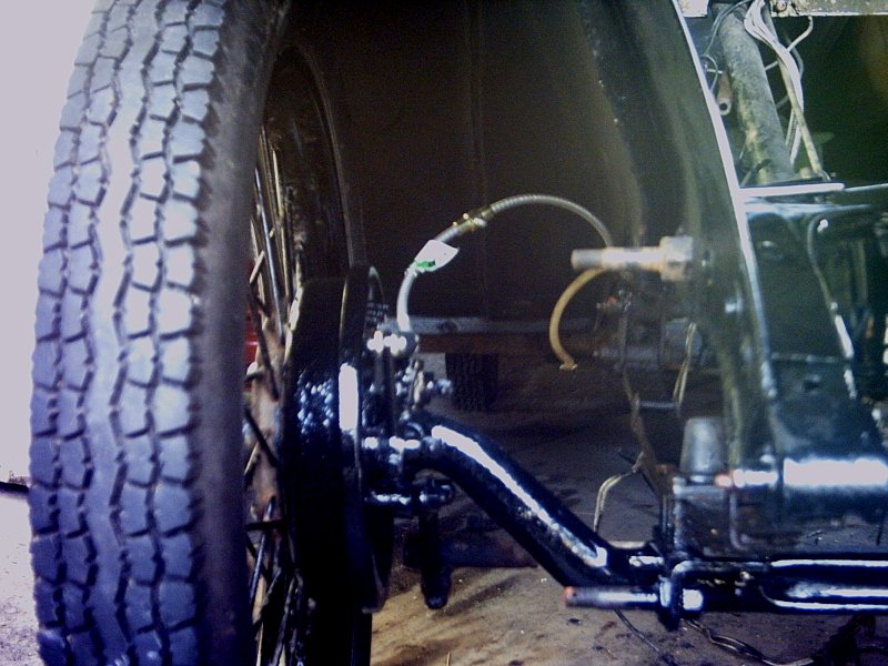

A quick update - the ash roof rail is made and in place, but I have not had a go at the cover yet - got cold feet over that at the moment.
So as I have the wings and other bits back from the paint shop I have put those on and rebuilt the front axle.

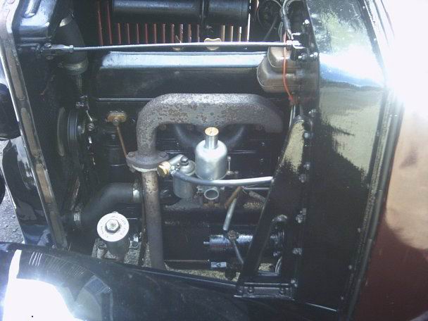

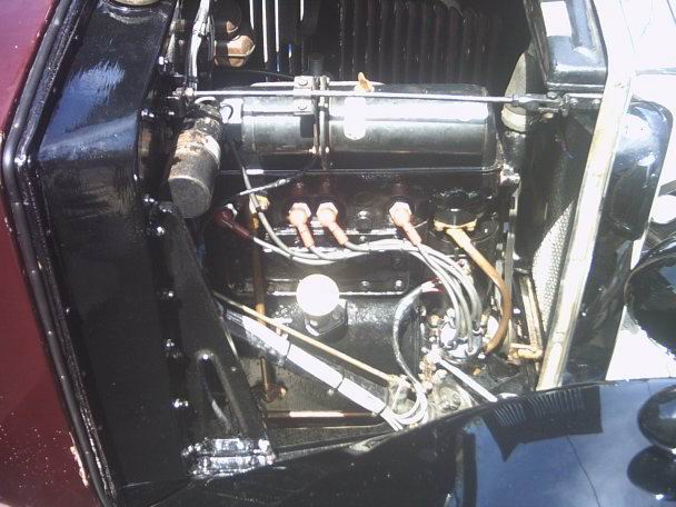

Rebuilt engine is now fitted, and just begining to put back all the remaining body work. Then I can carry out all the adjustments and book an MOT!

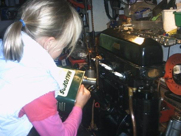

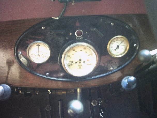

Some progress pictures:
Good oil pressure! Much better than 10psi before the engine rebuild.
Hopefully MOT this coming week.
cheers
Jeremy
