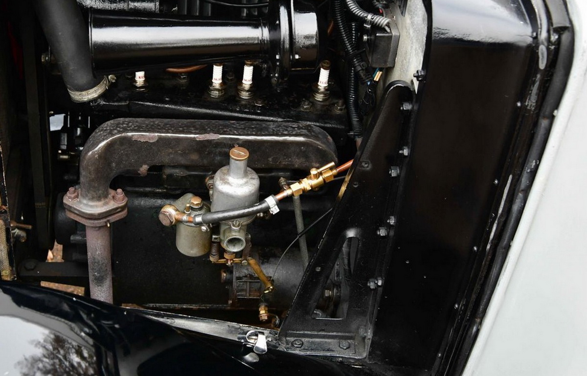

You are not missing anything, George. I have the same problem on several of my Minors, even when I have carefully rebuilt the taps with new seals. Getting the 'squeeze' right is the challenge - too loose and they leak, too tight and you can't turn the lever.
On the fabric saloon I just bought, Halbe has removed the seal, soldered the tap in the ON position and then added a new inline brass tap 'downstream' of it. In this configuration,k you lose the option of having a reserve (its soldered in the reserve position), but I've not had a leak with it.
