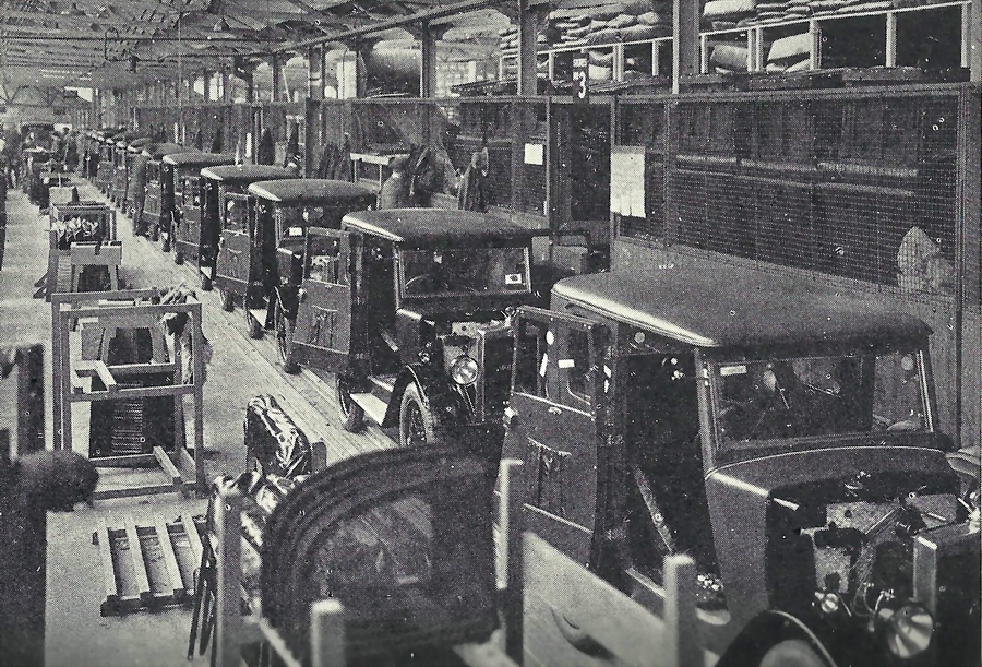

Currently starting to gather previously unpublished material for publication later this year. Some superb period photos are being researched, and I just received a superb article from a period trade journal from Robin Barraclough which describes in unprecedented detail the production process for the Minor, written in 1929, and with some fascinating photos, including this one showing a batch of fabric saloons progressing down the Cowley line.
I have not seen this photo before - has anyone else? I'd love to be able to read the chassis numbers on those chassis plates.
