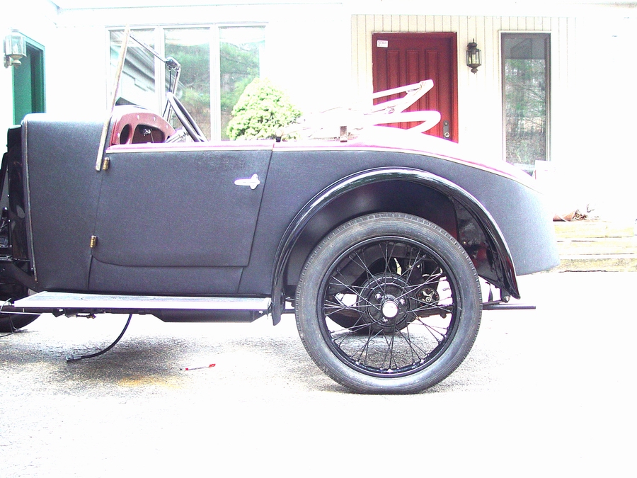

Andrew,
Thanks for the photos and videos - keep them coming!
The OHC Sports Coupe had exactly the same wings as the Semi-sports - that is - the early pattern shallow sideskirt and the inside triangular valences at the rear. If you check in original the Morris parts list you will see that these rear wings are specified for the Semi-sports and Sports Coupe.
So the ones you depict as the originals are indeed the originals. Your best bet for replacement would therefore appear to be a set of regular early OHC wings, and then make the small and simple modification of adding the inside valences.
The part numbers for your rear wings should be 5289 (offside) and 5290 (nearside). So, unlike all the other OHC Minors, these wings are handed.
Here's a photo of 5290 on my Semi-sorts. I've fiddled with the exposure so you can see the skirt depth and the inside valence behind the rear wheel.
Re: Rear wings...
So aren't those NOS wings you have the correct ones? They certainly look it, and would bolt straight on!
