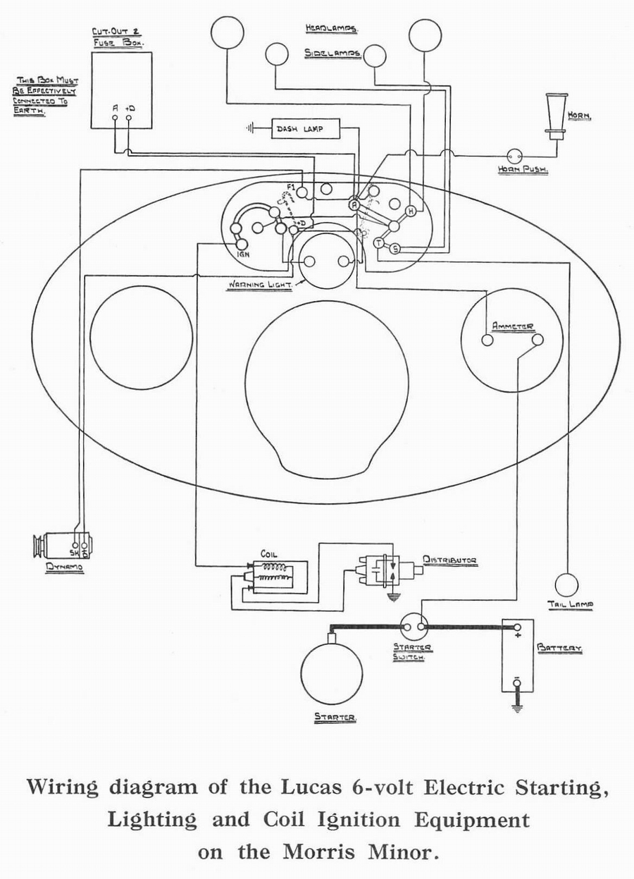

Here's the wiring diagram for the OHC Minor, with the same Lucas electrics and panel as the early. It shows that the charging fuse is housed in the cut-out. The resistor in the dynamo is a piece of resistance wire, insulated with some sort of period equivalent to insulting tape (spelling mistake intended! )

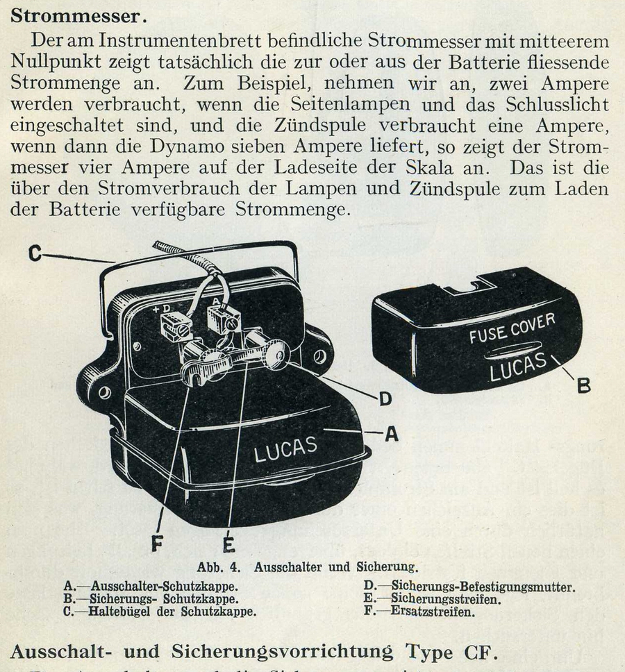

And here is the cutout, taken from the 1929 Minor Handbook (or Handbuch) - just for fun, in German. I have them in several languages. (Inside the front cover, it says "MOTORING LIBRARY, The Editor, Motoring, Publicity Department, British Motor Corporation Ltd., Longbridge, Birmingham."
You can see the flat fuse, with the spares between the two terminals. Most of the OHC Minors I have owned (probably about a dozen or so) have had regular fuse wire between the terminals, but some have had these original flat fuse tabs (or Ersatztriefen) still in place. A nice tie-decider for concours!

I think E Sicherungsstreifen is the fuse strip and F Ersatztriefen is a spare fuse strip. By the way Nick, thanks for your diode conversion which is doing a fine job in my M-type and the Rotax F Strommesser is no longer a fire hazard.
